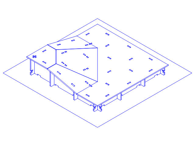

Unless I’ve overlooked something the isometric projection tool in QCAD only works with drawings that correspond to one of the cardinal directions: plan, front elevation, side elevation or their opposites. I needed to produce isometric views from some drawings of components that fit together at various angles as shown in the attached bitmap.
There is also a tool in in QCAD to produce a projection based on an arbitrary 2x2 matrix and it can be used to produce isometric projections from 2D drawings that are rotated and inclined to the cardinal directions. The attached pdf shows how to calculate the appropriate a, b, c and d values based on rotation and inclination angles.
