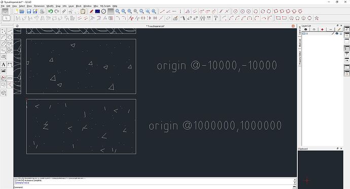

At 10000 units away from the origin it still looks ok apart from one single segment.
All other segments are also shifted somewhat but that is hardly noticeable.
Also notice the boundary crossings!! :blush:
Don’t know what is going on here, that is for Andrew’s to worry about.

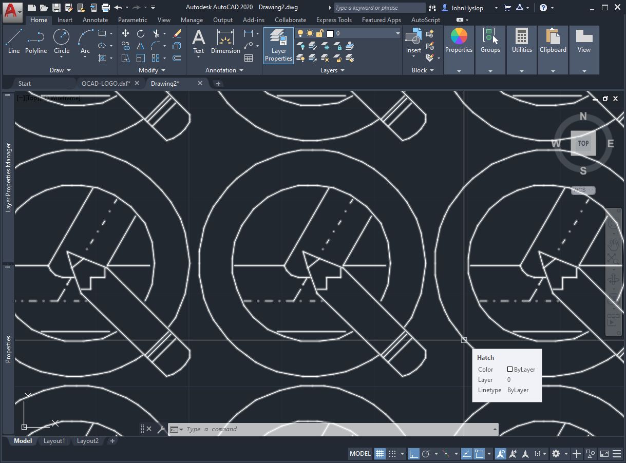

Hi CVH
I see you’re still busy on this…
I don’t know much about the maths involved
But I’m wandering why the AC tools work in a grid snap when creating the tile, could it be the answer?
The only drawback on this is you are limited by snap points…the lisp file you sent me works the same way.
What do you think?
Your tool produces really nice patterns but maybe we need to stick with simpler patterns because of this drawback..
Did you try my original pattern shipped with Qcad 3.24?
Does this have the same errors!
As far as the maths goes unfortunately I’m not much help.. it’s way beyond me..
Hopefully you’ll solve this soon.. it’s a very promising addition to Qcad..
PS the qcadlogo Andrew has is the original, the ones I have sent to you were modified to try out your tool..I have not reposted this one..

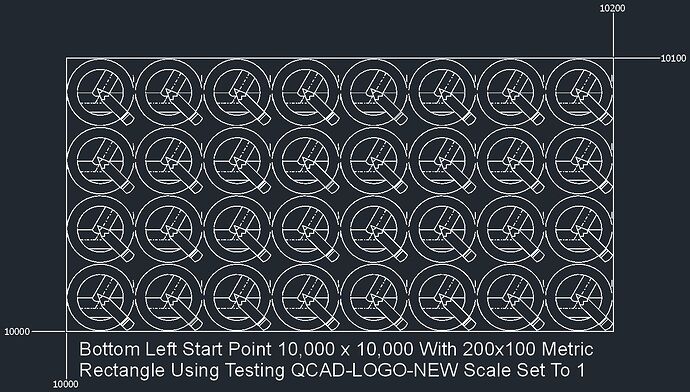

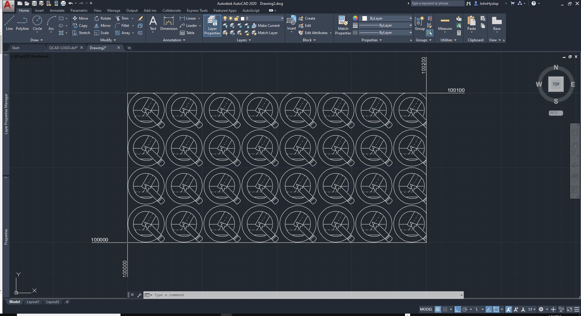

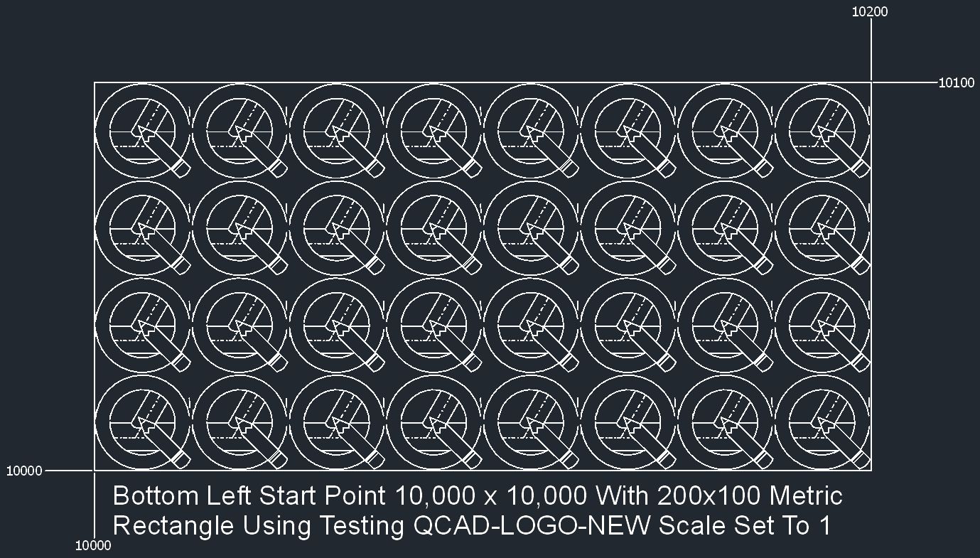

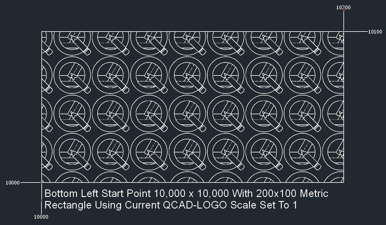

See Images Below:

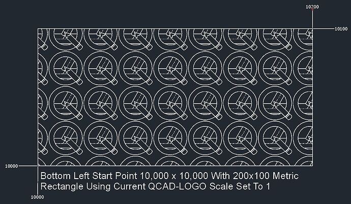

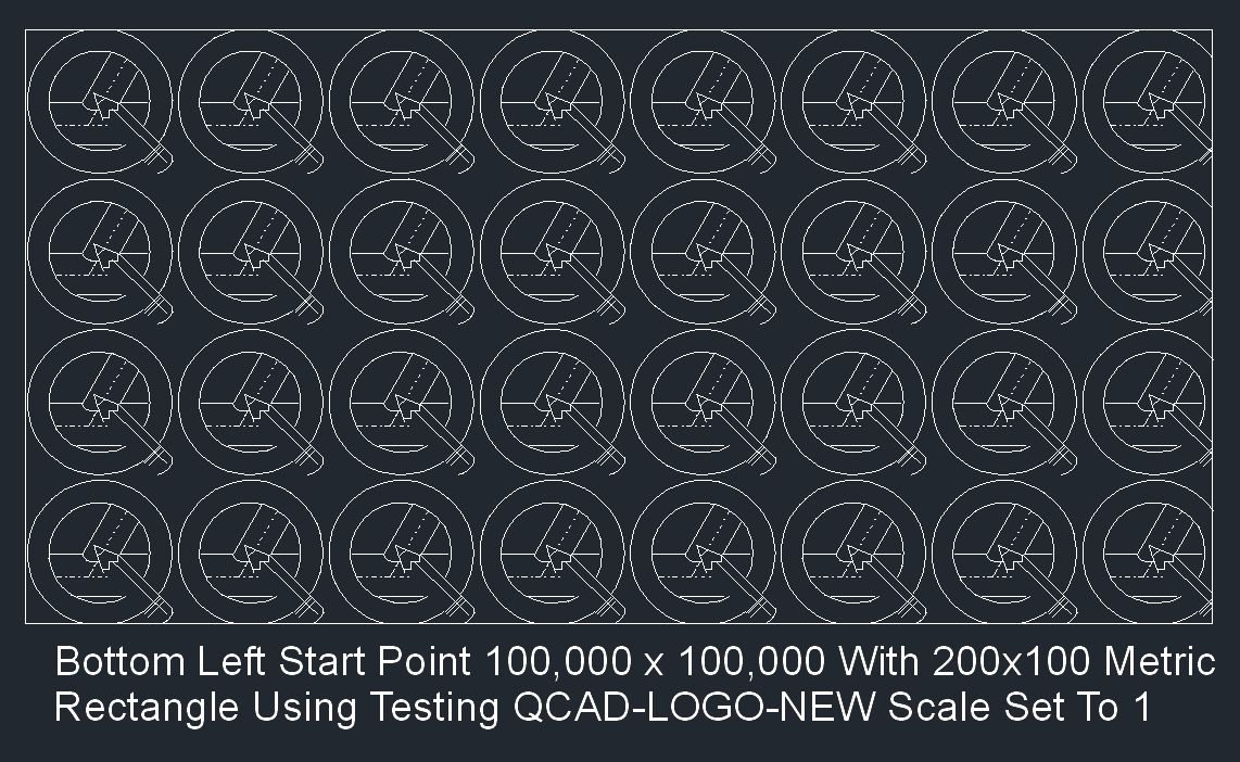

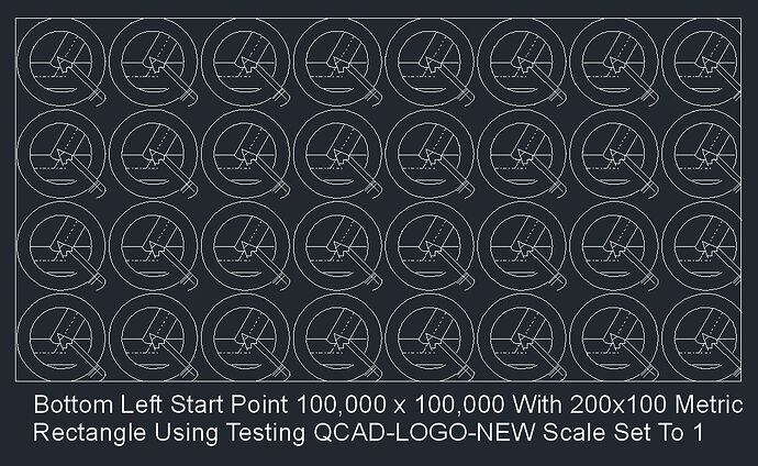

Hi CVH
See Below:
Hatch Patterns That Need to be Redone:-
Bubbles-01 ( not included in qcad build ) disaster at 100000,100000
Bubbles-02 ( not included in qcad build ) disaster at 100000,100000
Leaf-01 ( not included in qcad build ) disaster at 100000,100000
Leaf-02 ( not included in qcad build ) disaster at 100000,100000
Leaf-03 ( not included in qcad build ) disaster at 100000,100000
QCAD-LOGO ( Included in qcad build ) 1 line out of position at 100000,100000 ( but in AutoCAD is Okay? )
Squiggle-01 ( Included in qcad build ) disaster at 100000,100000
Squiggle-02 ( Included in qcad build ) disaster at 100000,100000
Weaving ( not included in qcad build )
I will fix these up in the next few days using grid method, I’ll repost in the Hatch Patterns Section
All the other patterns seem ok, ones that have straight lines and not curvy looking, the current
QCAD-LOGO seems ok, it was created using a snap to grid pattern .. ( but when shifted 100000, 100000 , 1 line on the pencil seems to shift?)
All the QCAD-LOGOS that I used for testing were only meant for CVH ( private emails ! ) not to be shared publicly same as his program is used
for testing, I have never at any time updated the QCAD_LOGO and CVH the dig you have at me about
Revisions is not nice at all, typically through AutoCad History they have changed patterns and Never marked
revisions on them, Drawings yes..should Qcad put revisions also on line command if it changes Line-R1, LINE-R2 ..I don’t think so..
Please also try and not be so condescending, I don’t say anything when you
make mistakes in your Tile2Hatch program as you have done!
Sorry to all users for the inconvenience ..

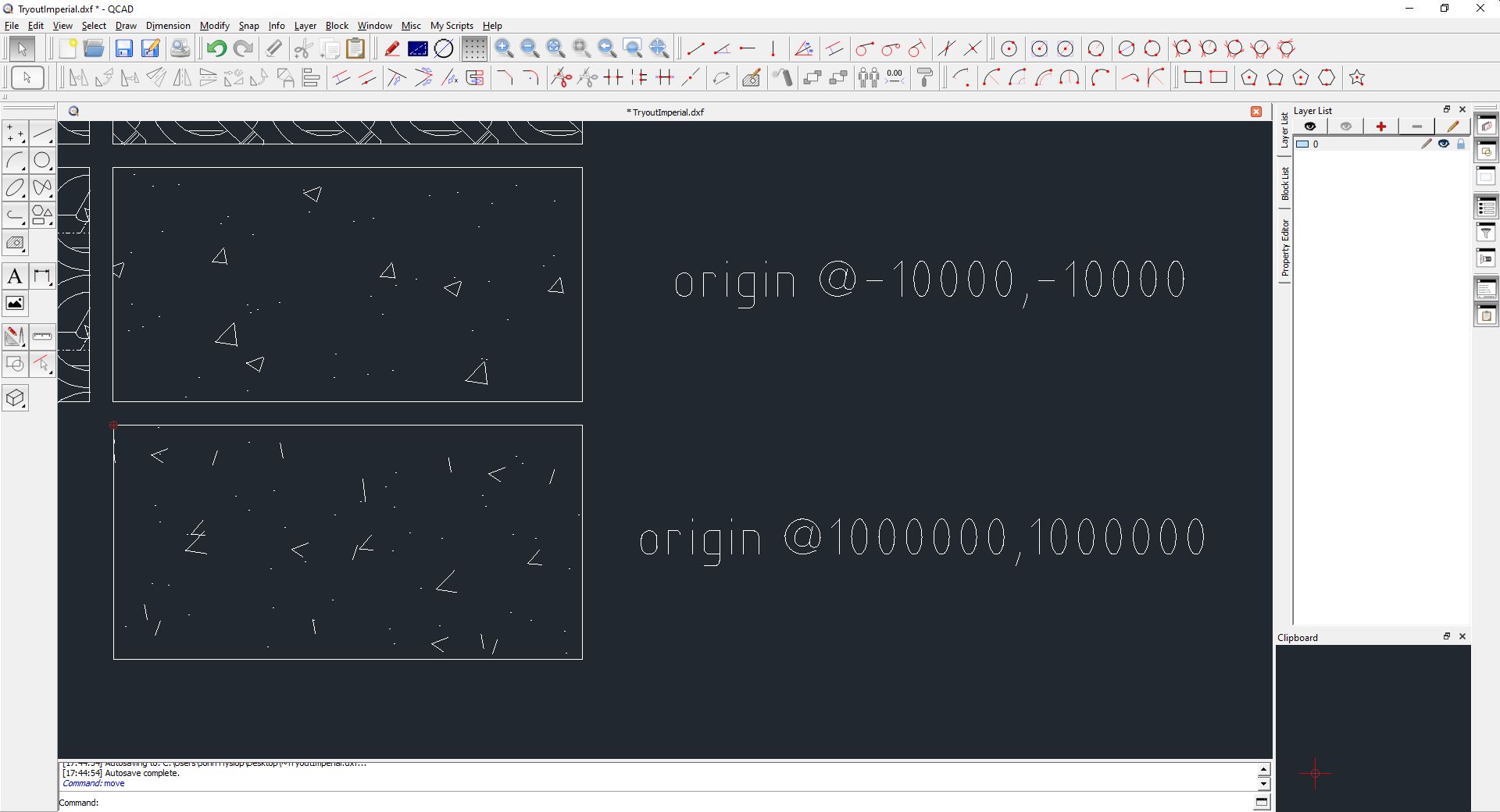

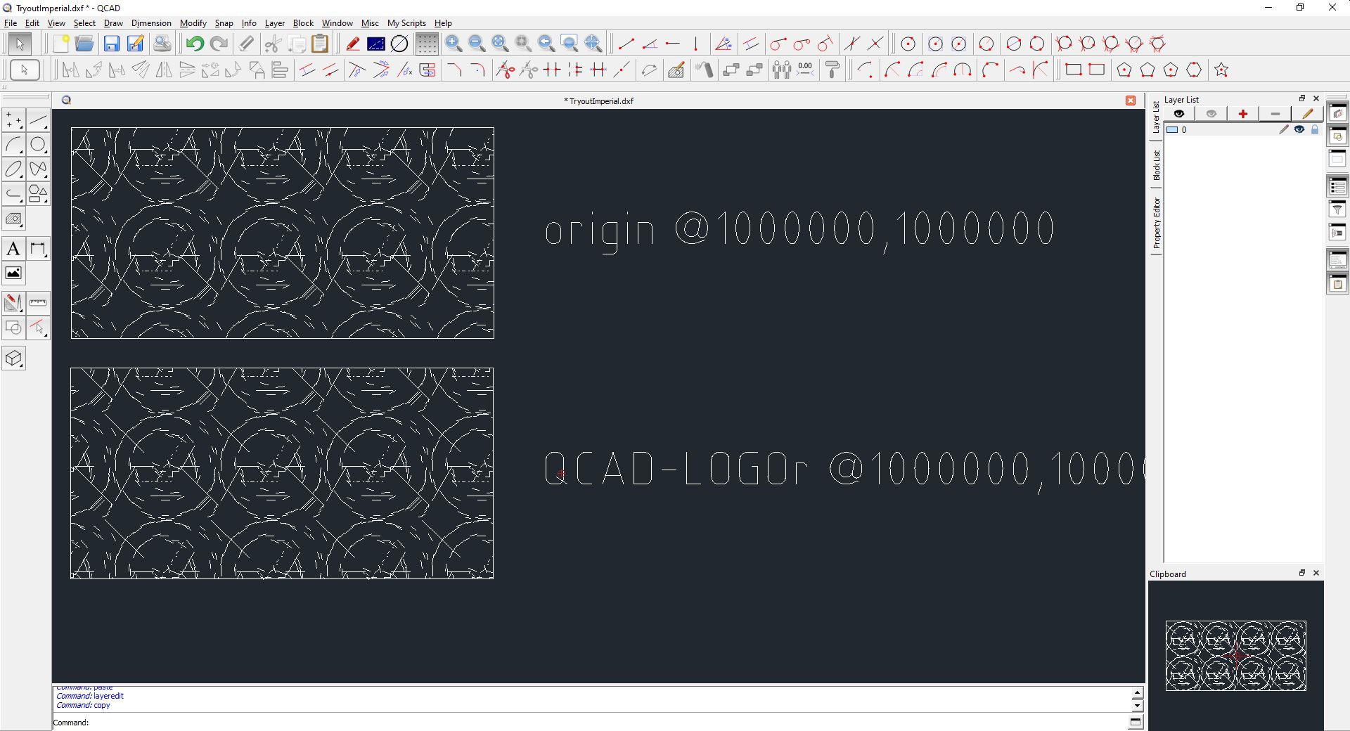

Hi CVH
I just downloaded your example dxf and QCAD-LOGOr.PAT
It has just as many errors as the original at that origin e_confused .. see
screen shot… out of 45 patterns I’ve made I’ve removed 9 from my posts
Mainly the ones that simulate curves 8 made with Tile2Hatch and yes the AC tool is no better
in Qcad anyway QCAD-LOGO was made with this.. the rest of my patterns seem ok

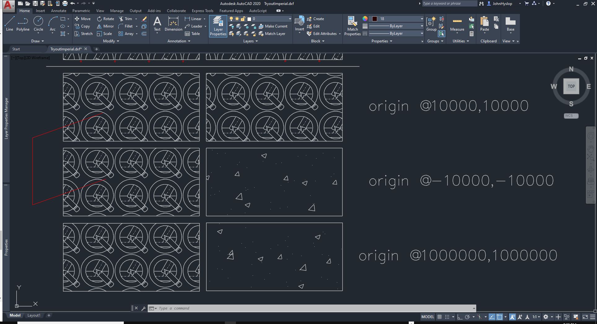

Funny if you google about entities far away from the origin point there are lots of
problems rendering in AC etc …Well onward and upward :slight_smile: hopefully you can work out
what is going on with the large shifts etc…
Most people wouldn’t work so far away from Origin but I see your point :astonished:

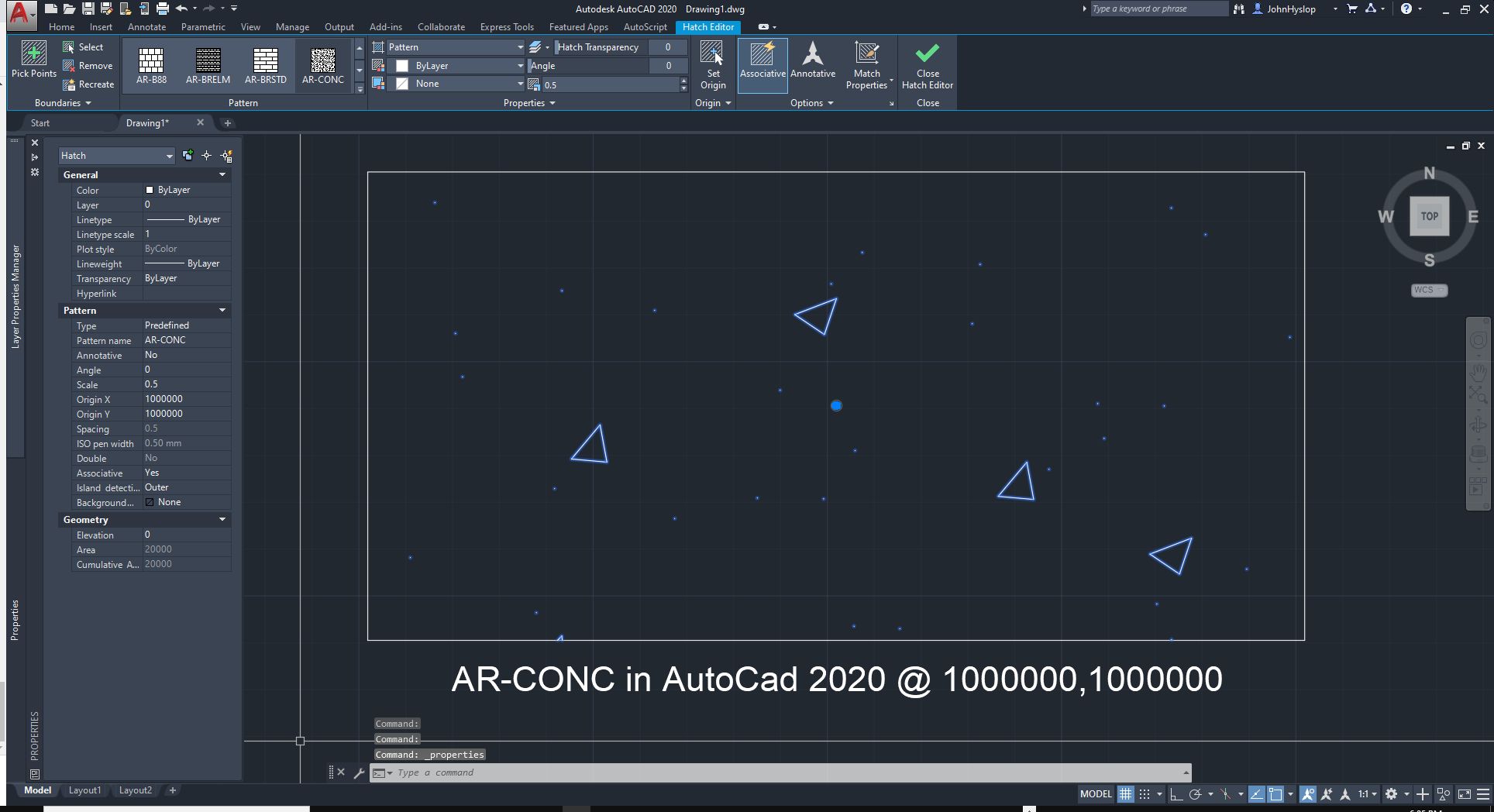

Even AR-CONC Fails at this origin and that’s a standard pattern e_surprised

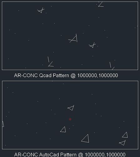

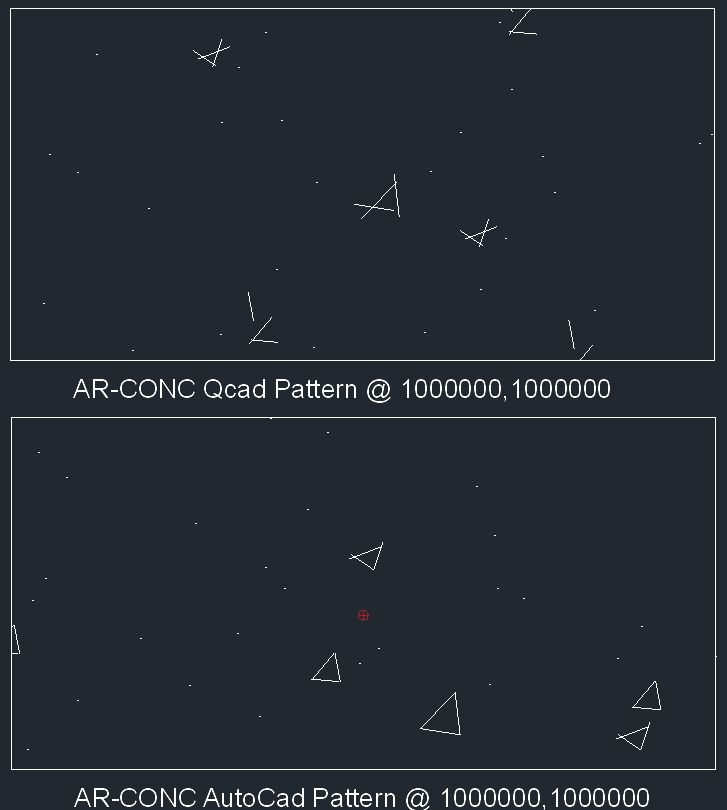

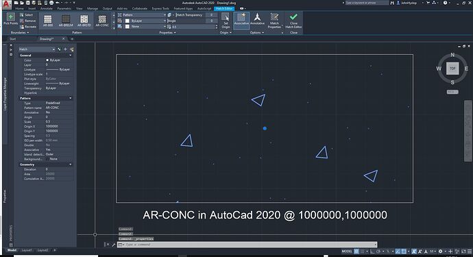

Hi CVH
You may of stumbled across a bug e_surprised see AR-CONC at 1000000,1000000 in AutoCAD 2020

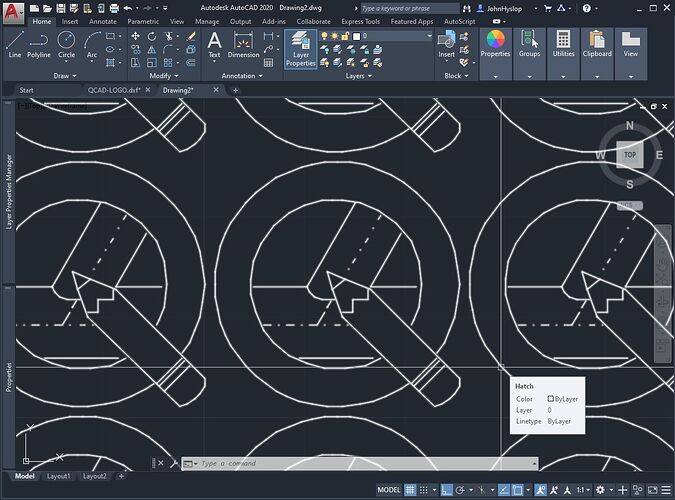

Hi CVH

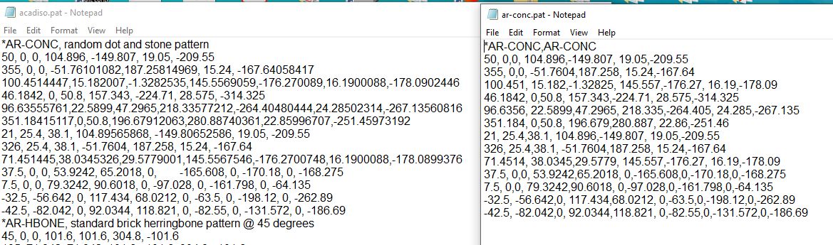

Just doing some more investigations on PAT files… see the differences between the AC one and Qcad
AC have more decimal places and also as I’ve said before they store all there hatch patterns in one file called acadiso.pat
Cannot upload this as it has a big copyright notice at the beginning of the file … I’ll try cutting and pasting a test file to see
if Qcad renders it properly at 1000000,1000000 …keep up the good work :slight_smile:
Hi CVH
Here is an example using the AutoCad Hatch I renamed it AR-CONC2 sorry can’t upload .. copyrights
Qcad still has trouble with the Triangles Yet in AC it’s Perfect? e_confused
I’ll keep testing :slight_smile:

You have a lot of reading to catch up on lol see above… I couldn’t resist opening your dxf file in autocad
look at the patterns !! what’s going on here… e_confused original QCAD-LOGO and AR-CONC at 1000000,1000000
PERFECT

for Qcad the question was out:
The answer is just in.
It is 15(.95) significant digits…
…puzzled but I think it fits
BTW @1000000 Is as far as the Hatchkit guys go.
Their example is metric @25000000.
All,
I think we might have hit a snag here. I can not call it a bug.
What I presume is that Qcad calculates all the offsetted paralles and shifts endlessly
and that AC at some point re-calculates a new origin and starts over from there.
EDIT: Redrawn, read further: John hitted the AC limit.
And that can be done with some proper math and with higher precision.
Its kinda the way I came, reversed engineering down to Tiles.

Hi CVH
So are we so to speak ā€œflogging a dead horseā€ ?
We stick to basic patterns 0,45 & 90 degrees? for standard hatches
Maybe the curved patterns can be addressed with
a … here we go again… DXFTILE?
Adding another 0 onto 1000000 and AutoCad begins to struggle too..
Unless maybe you can come up with a way to optimize the patterns
so they don’t use so many decimal places without loosing quality…
I have no idea, I don’t do this sort of coding and because of that I
didn’t understand Andrews answer to you.. e_confused
AC might use long doubles or rely on the 16th digit of 15,95… Ha e_geek :stuck_out_tongue: :unamused:
