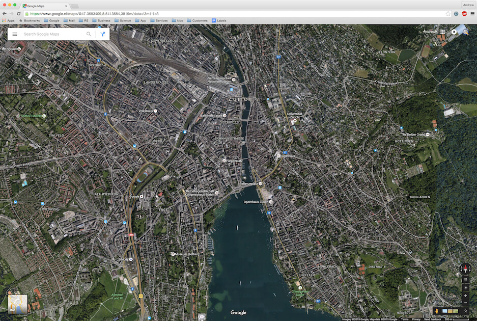

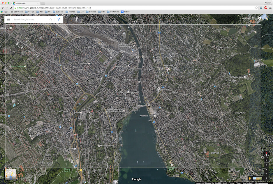

  • Take a screenshot of the map you wish to insert, for example from Google maps
  • You might want to crop the screenshot using bitmap manipulation software or Preview under Mac OS X, etc.

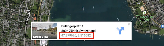

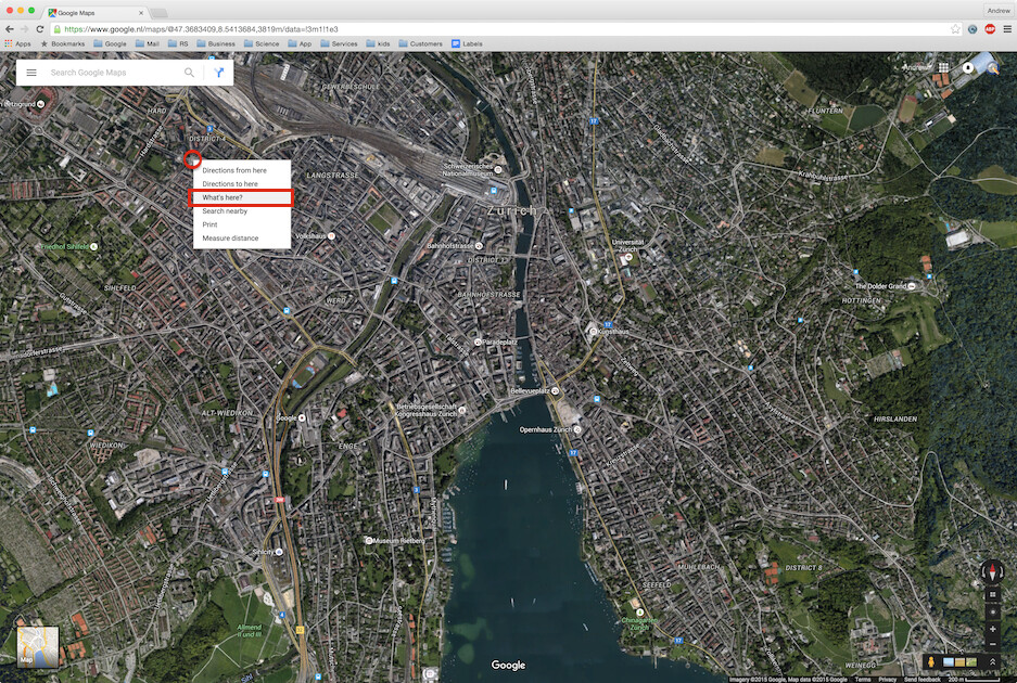

  • Note the location of two distinguished points A and B in the map. The two points should not be too close together. For the most precise result, choose two points as far away from each other as possible.
  • To query the longitude/latitude position of a point in Google maps, right click in the map and choose What’s here?.
  • Copy the coordinates from the bottom of the browser screen into a text document, etc. where you can retrieve them later.
  • For this example, the two chosen locations are [latitude,longitude (Swiss Grid projection)]:
    A: 47.379562, 8.516015 (681360,248194)
    B: 47.356608, 8.562908 (684937,245692)

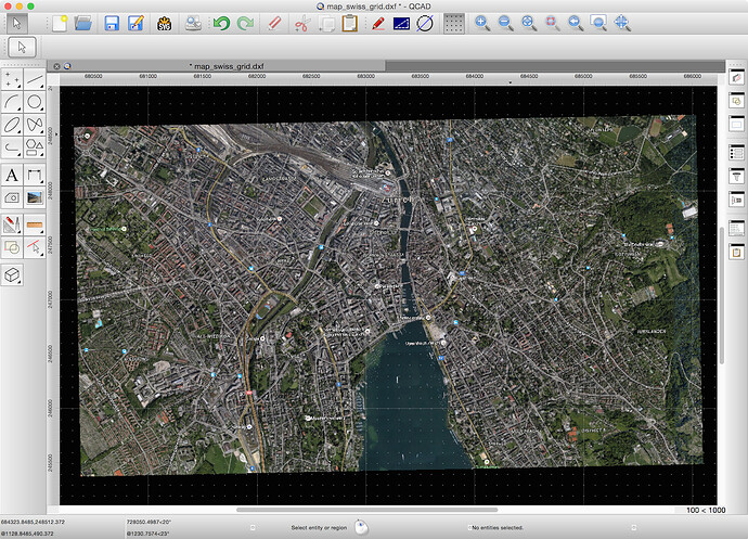

Inserting the Map into QCAD

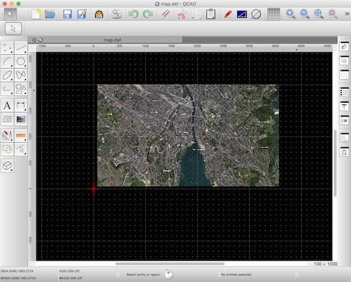

  • In QCAD, create a drawing. The unit of the drawing is typically set to the unit used for the chosen map projection but can also be set to None.
  • Choose Draw > Insert Bitmap
  • Insert the bitmap anywhere in your drawing. Don’t try to position or scale it correctly at this point.
  • You might want to move the bitmap into the background of your drawing by selecting it and then choosing Modify > Send to Back

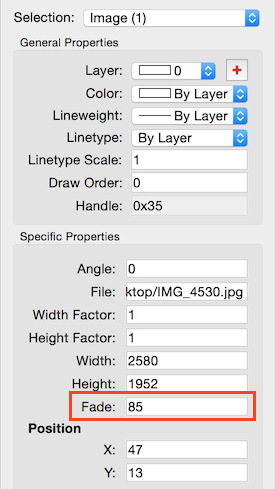

  • To draw on top of the bitmap, it can be useful to fade the bitmap (make it transparent) to make it less distracting. The bitmap transparency can be adjusted in the property editor: View > Property Editor, select the bitmap and adjust the Fade property:
    Positioning and Scaling the Map

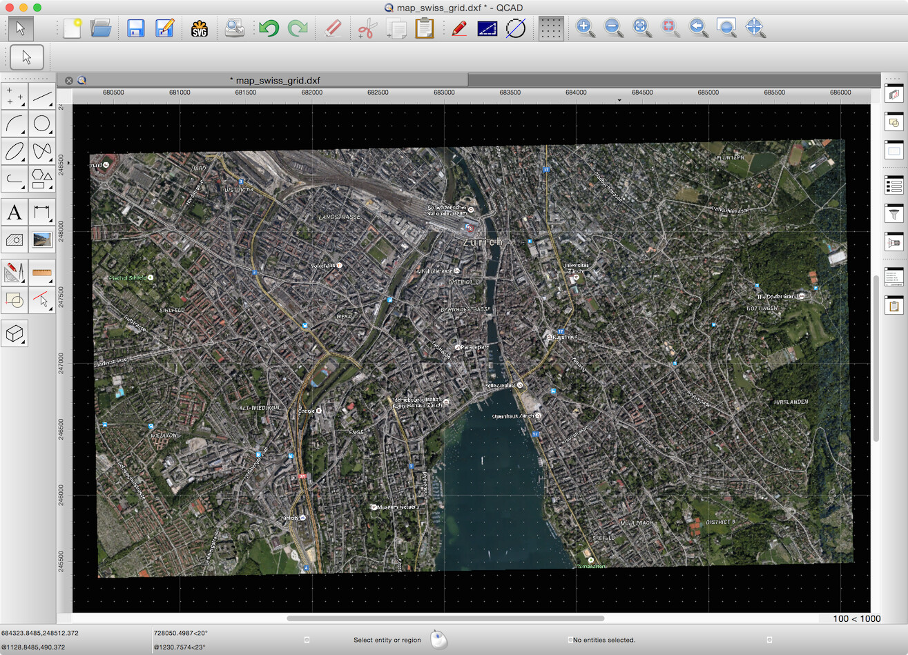

  • Select the inserted map. You can do this by clicking close to its border. The map is now surrounded by a red rectangle to indicate that it is selected.

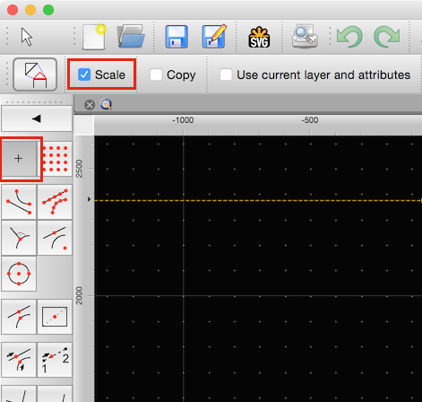

  • Choose Modify > Align Reference Points
  • Disable auto snap by clicking on the Free snap button at the left and make sure that the tool option Scale is enabled.
  • Click the first reference point A in the map.
  • In the command line, enter the known position of point A and press enter:
    681360,248194
  • Click the second reference point B in the map.
  • In the command line, enter the known position of point B and press enter:
    684937,245692
