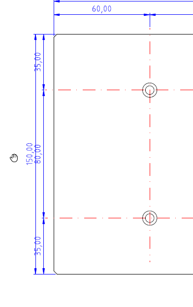

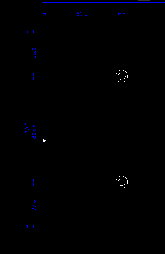

We have an issue when importing a ACAD dwg file with dimensions to QCAD. Our dimension are with a tolerance (fig1.) but when we import them into QCAD the tolerances disappear (fig2.).
Is there a way to import the file with the tolerance on it. Also is there a way to use the same type of dimensions we use in autocad?

Thanks. The tolerance has been defined as part of a dimension style. QCAD does not currently support dimension styles.
The logo was likely an OLE object (a Windows specific object type that relies on another Windows application to be rendered). This is also not supported by QCAD. Perhaps you could import a bitmap instead of vectorize the logo.

Note that you can add tolerances to dimensions in QCAD using the property editor (lower / upper limit). Whether this will be implemented this year depends largely on user interest and availability of time / resources from our side.
