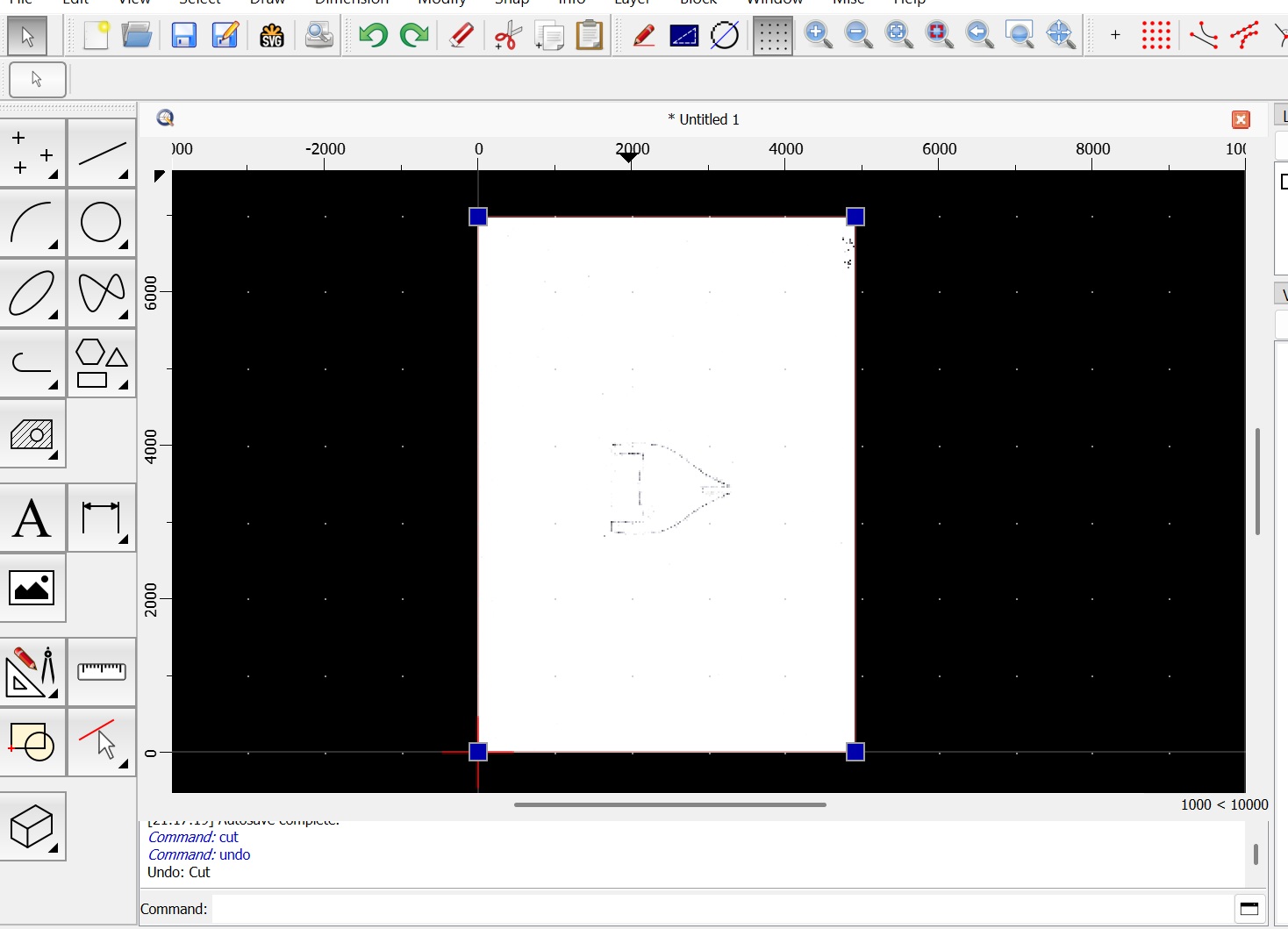

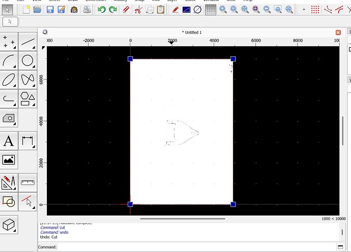

I have an Image on an A4 sheet that I imported into QCad. The sheet shows as nearly 4500 x 6500 whatever the sizes are on the screen but not the 210mm x 297mm I was expecting. How can I sort this out ? Please.

Your image is probably a bitmap …
Assuming your drawing unit is ‘mm’.
It would have been handy if at least the picture file was attached, see How to.
Also see above Forum Rules in red.
Bitmaps don’t store their actual size apart from NxM pixels.
The size of the visual representation depends on the DPI (screen/paper/…).
On importing QCAD treats 1 pixel as 1 drawing unit by 1 drawing unit.
Suspecting that the bitmap is ‘4500 x 6500 or whatever’ in pixels.
The aspect ratio of ISO A paper is sqrt(2) or 1.41421356…, 6500 divided by 4500 is 1.444… (not really a match)
On inserting a Bitmap QCAD displays the Width and the Height on the Options Toolbar.
  • Initially the width and height in pixels.
  • Ensure that the ‘Keep Proportions’ button is active (connected chain icon).
  • Alter Width to 210, Height should adapt to about 297 OR alter Height to 297, Width should adapt to about 210.
    If that is not the case then the aspect ratio of the Bitmap does not match with that of an ISO A page.
With ‘Keep Proportions’ inactive you can adapt both values but remind that you are scaling the Bitmap not uniform in X and Y.
This may change the original aspect ratio of your Bitmap in QCAD.
Technical detail: Screen dots are not per definition squares, printer dots can be. :wink:
One by one drawing units in vector art is exact.
Afterwards, if the Bitmap is already inserted as entity.
  • Select it.
  • Start the Scale (SC) tool.
  • QCAD requires a focus point, as per screen capture for example the left lower corner = drawing origin.
  • In the Dialog: opt for ‘Delete Original’, ‘Proportional’ active and set an appropriate scale factor. e.g. ‘210/4500’ or 0.4666…
    Input fields for values support simple to complex equations without the ‘=’ symbol.
  • Acknowledge the dialog.
The Bitmap entity in the drawing is now scaled with a fixed aspect ratio.
Not proportional you can enter 2 scale factors.
Quick and dirty:
  • Select the Bitmap.
    In the Property Editor:
  • Set ‘Width Factor’ to ‘210/4500’ (=0.4666…) here ‘4500’ is the current Width.
  • Set ‘Height Factor’ to ‘297/6500’ (=0.0456923…) here ‘6500’ is the current Height.
    Scaling the Bitmap not uniform with the given numbers.
    But then you’re comparing sour apples with potatoes, taking pixels for drawing units :wink:.
    To convert geometry in a Bitmap to vectors you have at best 2 known dimensions in orthogonal directions.
    Then it is possible to scale the Bitmap almost correctly in X and in Y.
    Tracing the outline as vector line art afterwards.
Another route is tracing the Bitmap as it is, scaling the vector art afterwards.
Bitmaps may also be rotated slightly.
Then ‘Align Reference Points’ (AE) with ‘Scale’ active can be handy.
Aligning 2 known, almost diagonally opposite points, in the Bitmap with 2 target positions in the drawing.

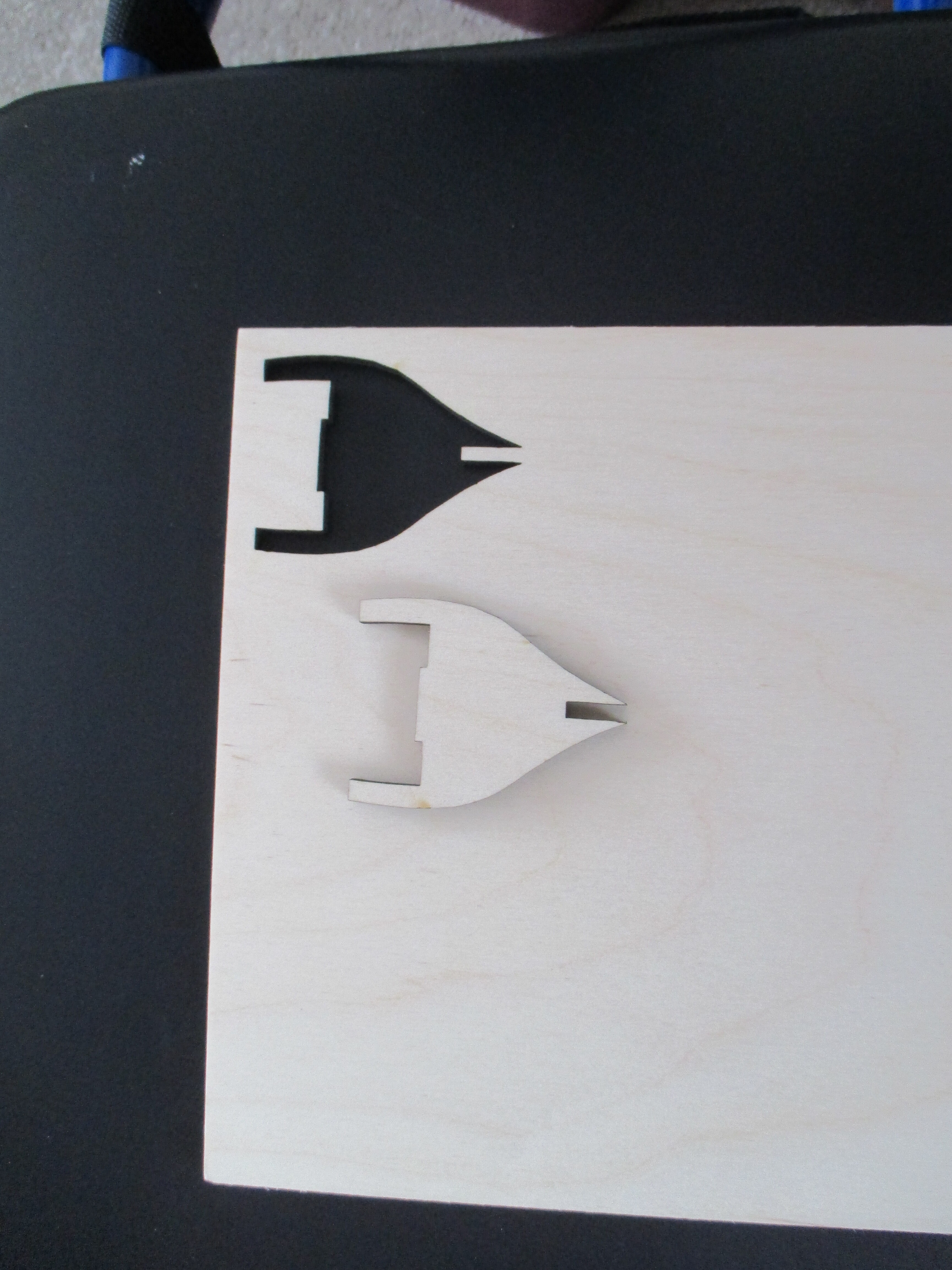

Thanks again for all your help. I have been out to the workshop and cut a frame from 5mm ply. This is exactly the result I was hoping for. I will get back to you in the morning as I am just waiting on my carer to arrive this evening.
doncraig
In answer to your last post I can say that I will need some more time to work through the options you mention but it all seems reasonable to me and it all depends on how I receive the original drawings.
However at the moment, as you can see from my last post I have finally managed to create what I want. I will now need to write out how I managed to get there and get it saved for reference.
