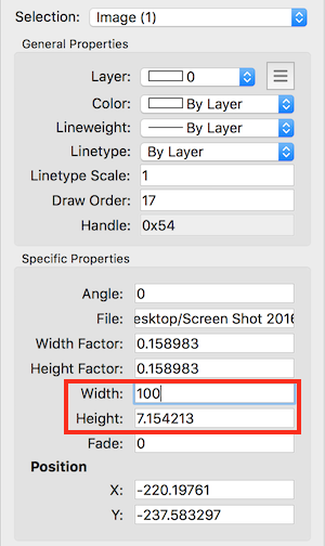

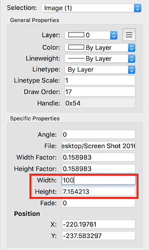

Adjusting the Bitmap Size in the Property Editor
You can also set the image width or height in the property editor (View > Property Editor):

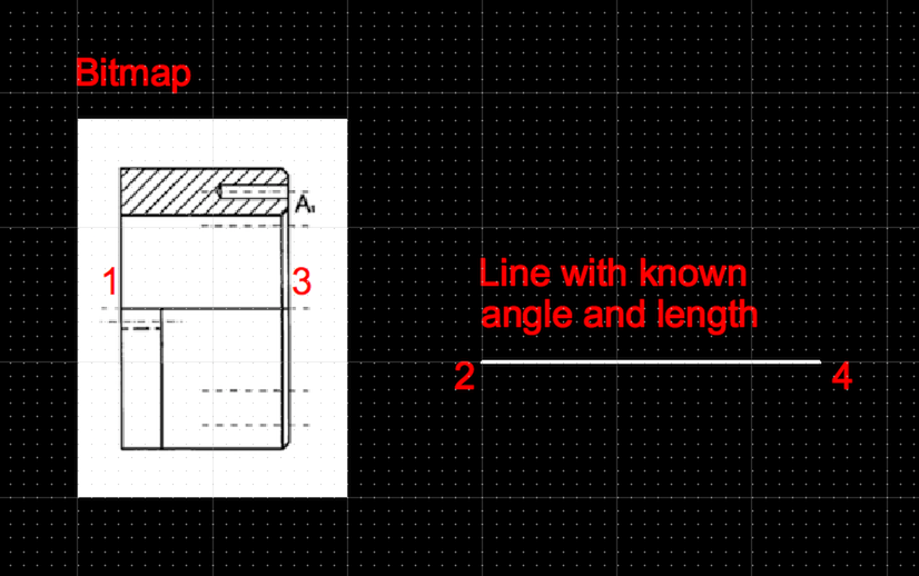

Aligning a Bitmap

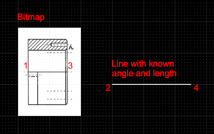

If you know the size of at least one particular feature in your bitmap or a distance in your bitmap, you can align (rotate and scale) your bitmap using Modify > Align Reference Points.
Situation after inserting the bitmap and click points for the align reference points tool:

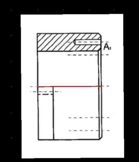

Result:
