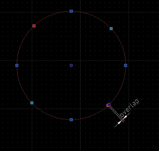

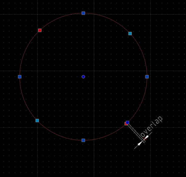

Normally, for these types of drawing, I’d recommend to work with polylines to ensure that all contours are closed. However, your drawings have overlaps which makes this difficult:
These overlaps are so consistent, that I suspect that this might be intended / required. Can you confirm this?
The nesting algorithm cannot identify which contours are inside others if the outer contour is not closed.
One workaround (while keeping the overlaps) would be to create blocks from your pieces. A block is a group of entities and always kept together by the nesting algorithm.
Indeed very remarkable … Consistent in their distance between endpoints equal to about 0.300.
But after some investigation most consistent in the Arc length … The length along the curve of the arc:
Varying only in the last digit: 0.29999998 - 0.29999991 - 0.29999993
What is a match with the linear overlap of 0.30000000 for the outer contour.

IMHO a single and very consistent overlap of give or take 0.300 at arbitrary orientation for each closed contour is not a manual creation process.
Also, it occurs as linear overlap for straight edges and exactly the same as arc length for curved edges.
For an accidental mistake it is too consistent in nature :exclamation:
