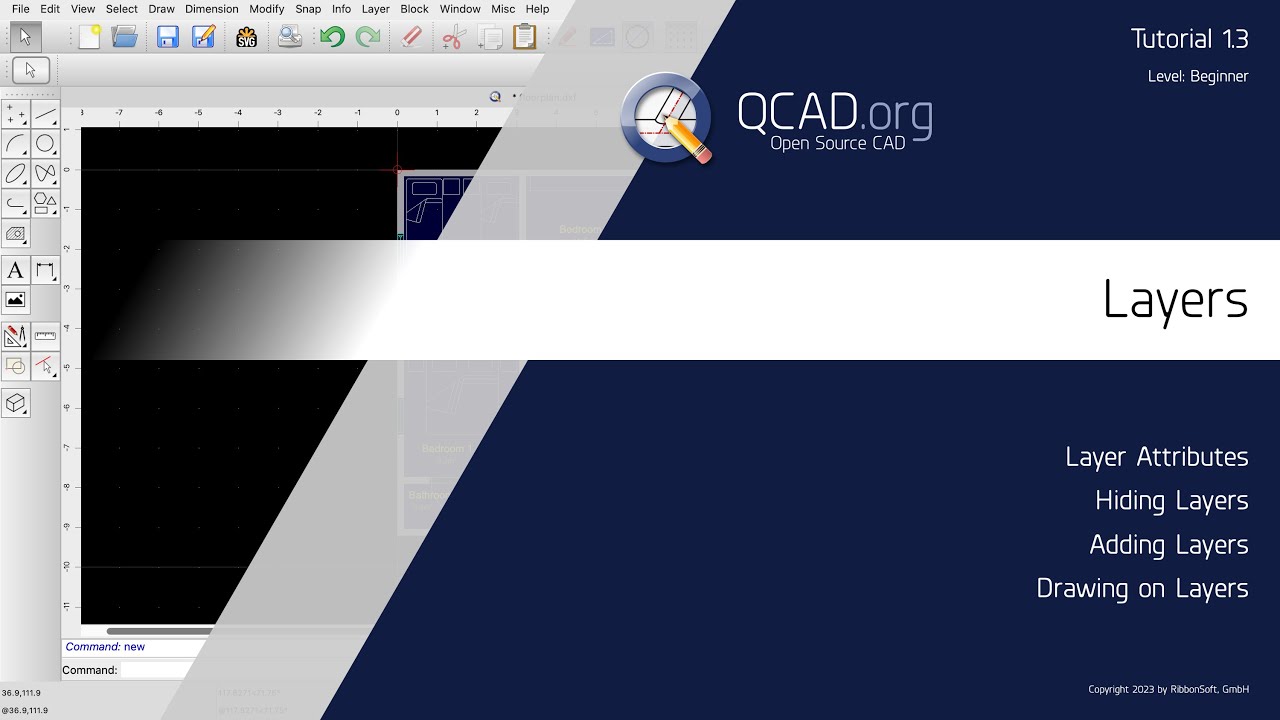

Using Layers
Attributes are typically controlled by layer in CAD. For each attribute combination, create a unique layer. Layers are essential in CAD. Each layer holds related entities (walls, dimensions, electrical, text, …). Related entities with the same function must have the same attributes. On a paper, we do not have layers and the function of an entity is solely defined by its attributes: a dashed line means the edge is invisible, a blue dashed line might be an electrical wire, etc.
