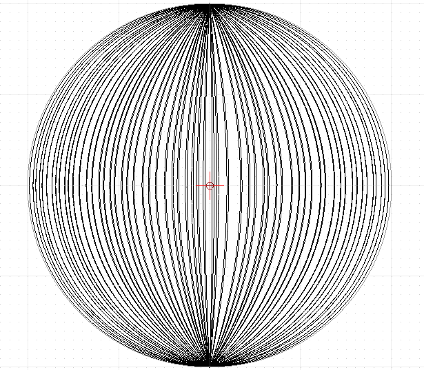

Hi I am using windows 7 and Qcad 3.17 and I am trying to draw a globe with tapering latitudinal and longitudinal lines. The longitudinal (pole to pole arch’s with decreasing spacing between the pairs as they move away from the center, then fill in the pairs to make tapered lines ) was not too difficult , but the latitudinal ellipse pairs have me stopped , also the globe is made from closely (but random ) spaced lines .

The longitudinal lines look like this ( before filling )
the latitudinal lines would be like on a globe of the earth . the last reply was deleted for too few words but I have no idea how many is enough and I don’t want to do this a third time , marry had a little lamb his fleece was wight as snow …

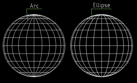

Comes this close to that what you are looking for?
Thank you for the reply but those are longitudinal lines not latitudinal and your latitudinal lines are just straight horizontal lines
I need elliptical “Horizontal” lines in tapered pairs .
these are the vertical lines , BTW how many words are required in a post to not get it deleted and why delete peoples posts any way ?

The globe with the longitudinal is actually much larger and was shrunk to fit the screen , All the pairs taper to the same point at each pole , there withs and spacing is random but seen full size they smoothly taper from pole to equator to pole , the effect in full size is very eye catching .
