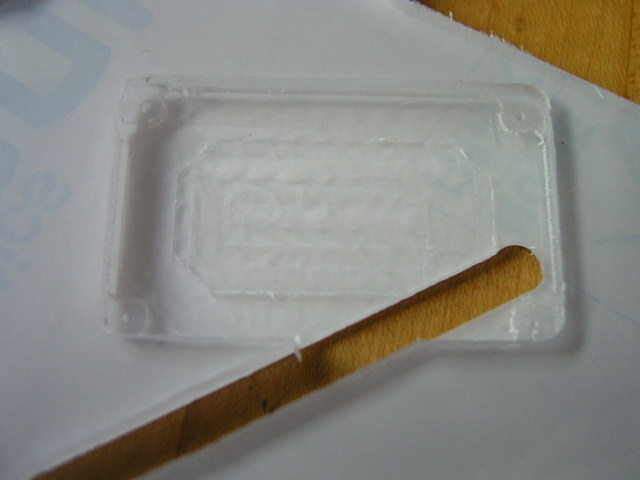

I have an additional question. I ran this an a piece of Lexan, everything ran fine till it came to around line N3540 or N3550. It did the last cut and it was going to do another tool change, the Z2 then it Z10 and then it G28 (return to home) before it move in the X/Y the Z went down Aprox. 10 mm below Z0 then went to home gouging the Lexan. Just running with out material, I ran the G-code a few time and it did the same thing. I edited N3550 and deleted G28 and I could run the code without issue, it just went to Z10 position and not to Home. Which was a good work around to the issue. I added a picture to give you a rough idea and the G-code. I have no Idea what could have caused it.

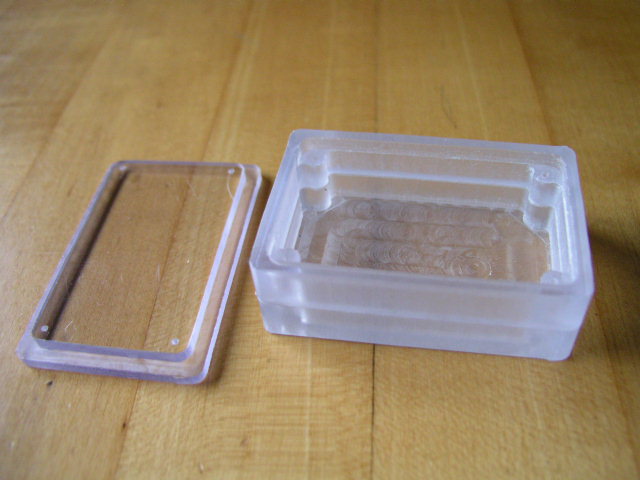

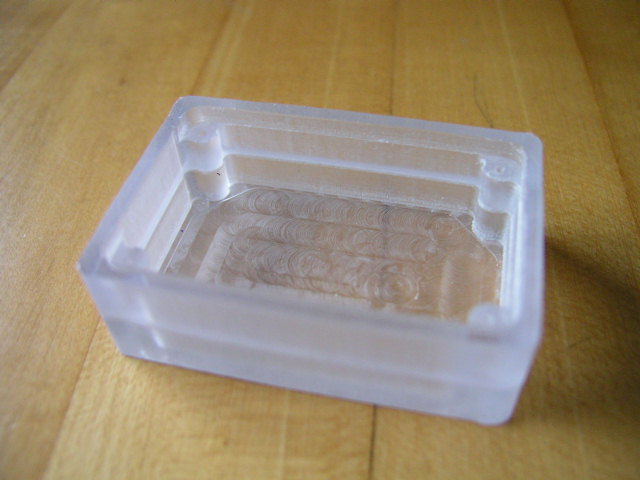

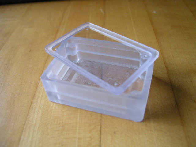

I am lost, thought it may have been generated in QCad/Cam, but I doubt it. I have a Gremlin in my system that pops up and disappears. I did the full version of that G-code and had no issues and worked perfectly. When I first executed the G-code the spindle went up beyond its limit, I stopped it and started over and it worked with fine. It is like the system get confused and goes rouge. But I got the box done and fits good. It is only an exercise doing pocketing with multi layers, with inside profiling. I used Chinese/ single flute end mills got from EBay, for the acrylic. This is my results. So I guess I will contact Mach3 people to see if they have any ideas!
