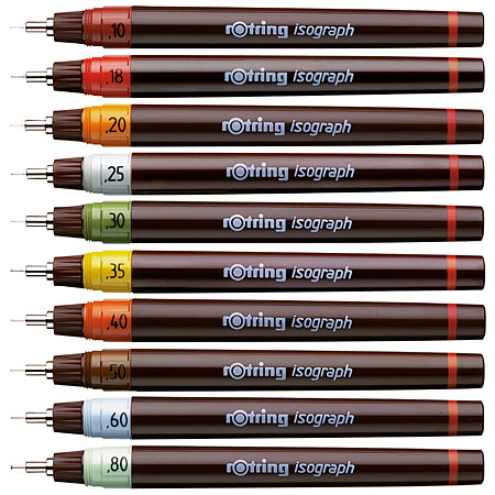

These are invariant physical properties of refillable pens with ink … For example:
You may discover there the exact same sizes as the most common CAD Lineweights.
When Screen based Linetypes (and weights) is active it is again represented visually in a pixel based hybrid form.
So that a thick line looks a bit thicker than thin lines and there is a minimum of 1px.
A representation … Not an actual real world size.
Say you zoom out in Model view factor 100 … A line in pen size 1mm would reduce to a fraction of a pixel wide.
Should it be displayed or not? Best choice is yes otherwise your drawing panel would quickly turn empty.
Now zoom back out and zoom further out factor 100 … The same pen would now span 100mm wide or about 380px in 96 dpi.
A line in this pen is about 1/3 of my screen height.
Would you consider that workable?
On paper this pen will always draw a 1mm or about 0.394" thick line, disregarding the paper size and a paper scale.
And with Screen based Linetypes turned OFF it will display 1mm wide converted to any drawing unit (with a minimum of 1px).
