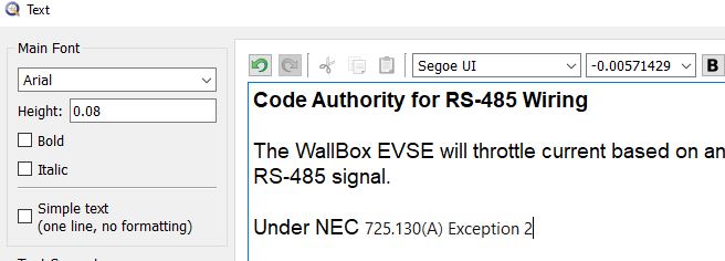

I still can’t paste in plain text mode to the QCAD Text Editor widget.
One of the source I often use is copying text from the Command Line history, especially results from the info tools.
These are handle by EAction.handleUserInfo(…) and are in color #0066cc by default.
After selecting a portion of text one can not copy that with Ctrl-C but one can use the context menu: R-Click .. Copy.
Ctrl-V, Shift-Insert and context menu .. Paste are all in Rich text, Ctrl-Shift-V is not functional in the QCAD Text Editor.
It is thus not the question of ‘reinvent the wheel again’, it is a question of implementing an extra context menu method to strip formatting.
Or to support Ctrl-Shift-V in the QCAD Text Editor and deprecate this shortcut for PE.
The work around is to set your text to simple or edit the source of your text directly.

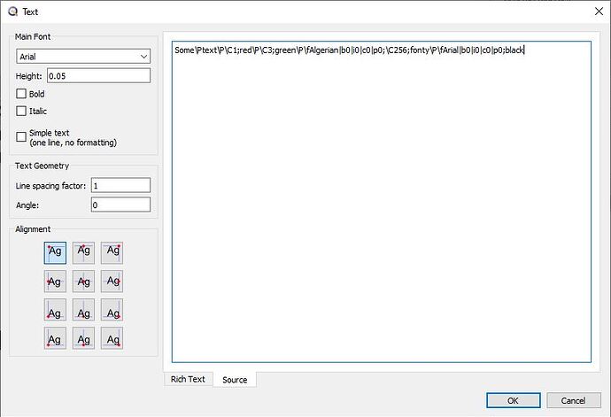

As of qcad 3.32.6 pressing Ctrl-Shift-V (Windows) still results in Command: pastealongentity
The workaround I am now using is to paste into the “source” tab. That correctly handles unicode, operating just as Ctrl-Shift-V does in most programs. In most programs the text inherits whatever formatting is already in place at that position in the document (be it header, footer, plain text or whatever).

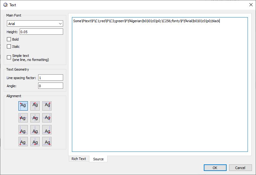

Using the “Source” tab has the same beneficial behavior.
Just pick your spot and CTRL-V and the text will inherit the current formatting as desired:
Some\Ptext\P\C1;red\P\C3;green\P\fAlgerian|b0|i0|c0|p0;\C256;fonty\P\fArial|b0|i0|c0|p0;black
Using the “Source” tab also avoids issues reading the rich text when the zoom levels are extreme.
What would be nice if if the cursor would track between the “Rich Text” and “Source” tabs. The font in “Source” is tiny, and finding the right place to plain text can take a while. If the cursor transferred, then it would be quicker.
