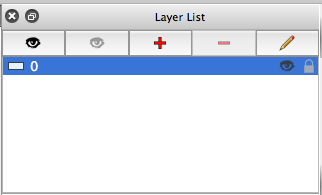

To make sure you know what layer you are working on, make sure you have the layer list enabled:
View > Layer List
For new, empty drawings there is only one layer present: layer ‘0’. This layer can never be deleted.

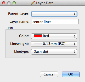

To draw a red, dash-dotted line to indicate a center line, create a new layer:
Layer > Add Layer
Give that layer a logical name, for example ‘center lines’:

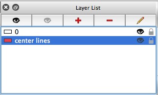

Whenever you draw a center line, make sure that layer ‘center lines’ is active in the layer list:
The line you draw will automatically have the desired attributes.
If you decide later that all center lines should be hidden, simply hide that layer (click on the eye icon). To change the color, linetype or lineweight of all center lines, simply edit that layer (Layer > Edit Layer).

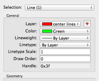

Changing Attributes
Attributes of existing entities can be adjusted using the property editor of QCAD:
View > Property Editor
Select one or multiple entities and change the color, linetype, lineweight to the desired value.
