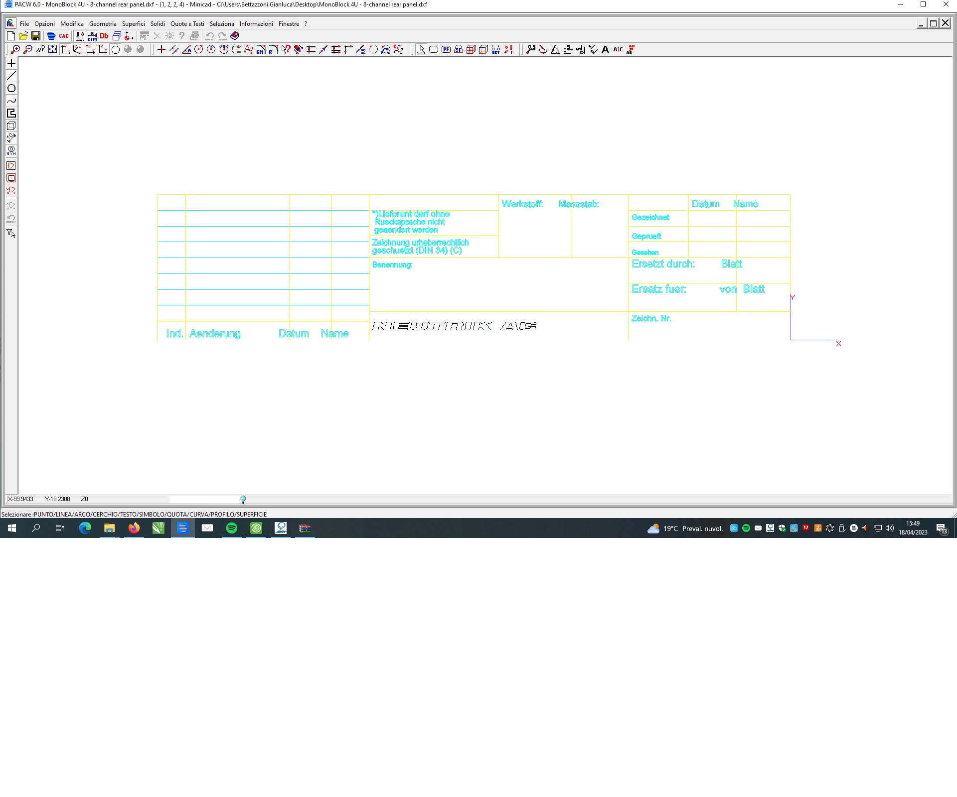

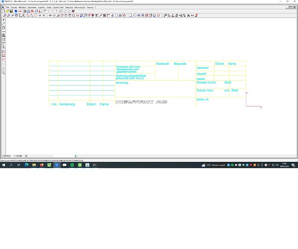

The only thing the vendor sees is the attached image. Nothing from my own drawing! I do not know what space he is looking at. I do not see anything of what he sees (the Neutrik title block and info). Very strange.
I wonder if whatever I did somehow corrupted the dxf information.

BTW … Not able to locate ‘PACW 6.0’ and ‘miniCAD’ doesn’t look like what is in your image.
