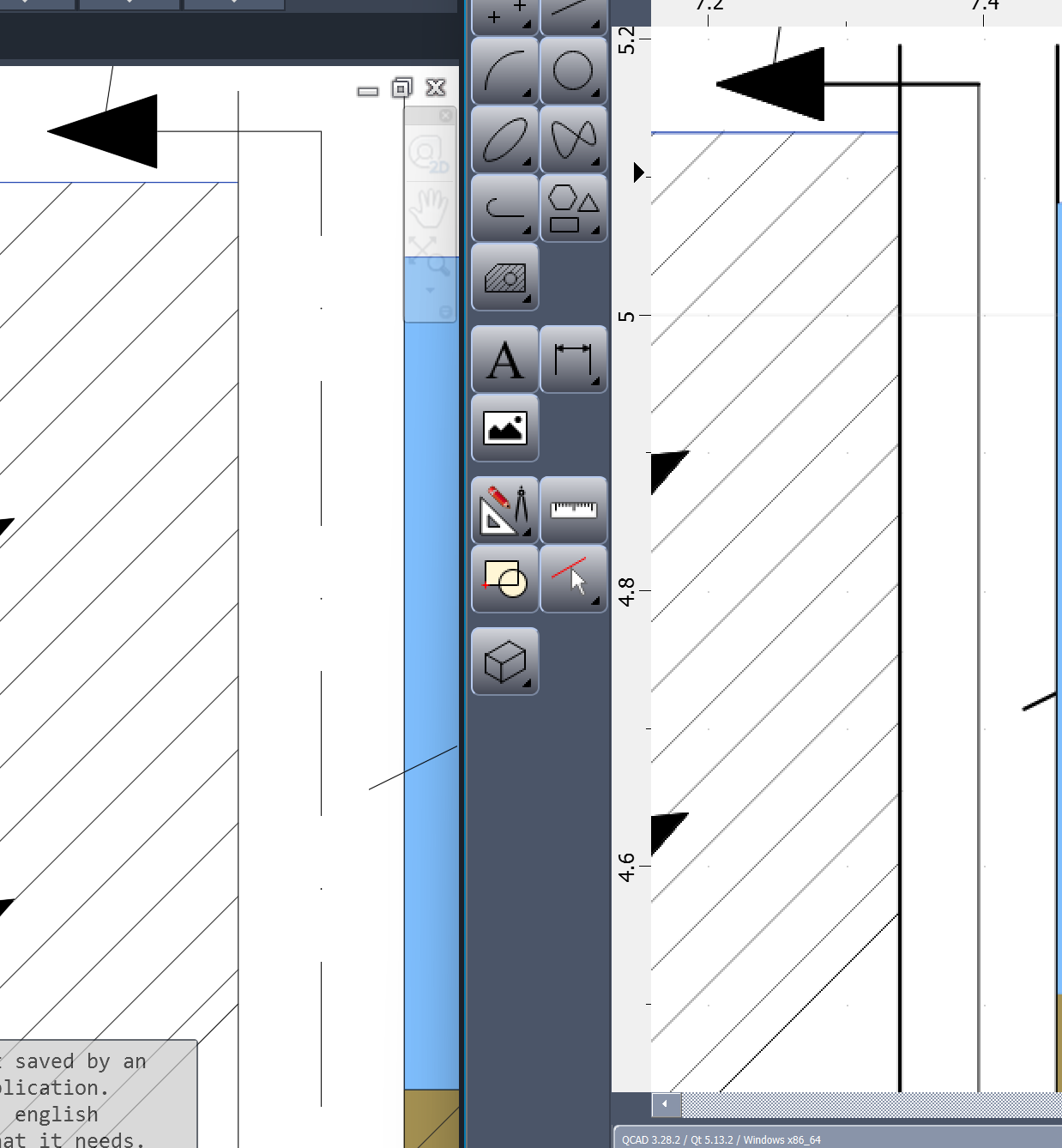

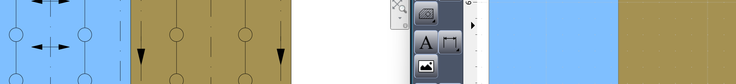

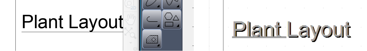

I am currently experiencing such an example. Unfortunately I don’t quite recall the artifacts from the last files, but for my current one what i can see is that dashed lines do not appear as they should, the display of underlining of text is incorrect (partially not there at all, partially slightly misplaced or only for part of the text), and it seems the order of objects has changed. I have some solid hatches, where there should be lines on top, but in QCAD (and a PDF printout from there) I only see the solid hatch. I can however select the hatches and bring them into the background, so the lines re-appear.

I will attach some screenshots trying to display the issues. Left side is always DWG TrueView while right side is QCAD. I hope this illustrates it sufficiently (i know they are not the best).

QCAD is never intended to be an AutoCAD clone.
It supports most basic things based on the DXF standard.
DWG is a binary file format while DXF is the textual file format.
There are some specifics where a DXF converted from a DWG is not fully the same.

For your text entry:
Not all DXF formatting features are supported, some only partially, some in a different way (Stacked text for example).
Not all to none of application based special formatting is or can be supported.
Sometimes it doesn’t add up to start with.
As far as I know in QCAD underlining starts after the ‘/L’ switch and ends before an ‘/l’ switch.
Please include the full source string so we can replicate the rendering. Indicate the font if that is not part of the source.
About dashed lines:
Lines or polylines? … Polylines with custom width?
Using Screen-based Linetypes or not?
Is the linetype scale correct and which of the two applications is doing it correctly?
Sometimes it would be required that QCAD must adapt to something different or wrong for the sake of being compatible.
NOT at all, when this conflicts with the DXF standard, by preference where possible and ultimately it is a choice to make.
It should be possible to copy the dashed line and what extra details to a new file as example without harming confidentiality.

As for the linetype display, somehow I can not recreate this anymore with the same file. I have adapted the lines since and have no old version available, where this is still the case. In this specific case it was a polyine. I will have to read and understand more about the linetype scaling, display and printing as this was something that I always have to play around with to get it right in paper space after drawing in model space.
I have copied some of the text with the underline issues into a new file. What is interesting is that if when I double click the text to edit, but then just save and close without any changes, the underline changes and is displayed correctly.

{\LPlant Layout} => rendered as Plant Layout on Model.
And indeed rendered differently in Model compared to Text Edit.
Perhaps faulty in Model:
  • All is underlined until after the first space.
  • Nothing is underlined without a space.
  • All is underlined without an \l switch, without curly brackets.
  • Everything is perfect when using the \l switch at any point, with or without curly brackets.
I am unsure what the behavior should be without an end switch.
That may already be different within a {…} group but then I would expect the format to be in front of the group.
QCAD doesn’t exploit these format groups itself.
The question remains how well these are supported and if the usage is conform DXF specs in this case.
