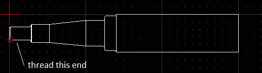

Basically I want to thread end of shaft in Qcad.

Hi Andrew,
I have a shaft and I want to thread the smallest journal on the end of this shaft.
More correctly I want to draw the shaft with a thread on the end of it, much like the bolt shown.
Thanks.
Kevin
