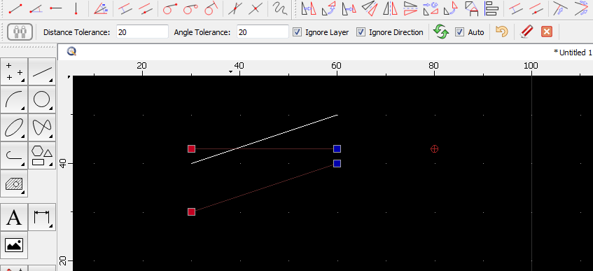

Large tolerances are no solution either.
This is even rather or very dangerous in complex designs!
In this example the horizontal is not selected by angle tolerance but by distance !!!
I presume ‘angle tolerance’ is for arc segments … ?!
In Husky’s example a value of 35 or so would select almost every entity.
