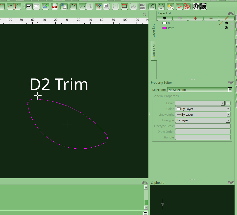

D2 / Break Out Segment “Trim” / Unexpected Additional Entities
See Attached dxf and gif below.
trim-error
D2-Trim-Error.dxf (153.5 KB)
This should be fixed for an upcoming release.
Splitting an arc as full circle at two given split-points may result in an unexpected shape, even in a more than fully circular arc.
bambuko’s reported issue with HS is related to that.
Limiting an indicated arc to a connected segment for a boundary contour.
The flaw also affects Modify .. BreakOut and a new test case is added (hits 1& 2 in that commit)
But it may even that you stumbled on an exception that is not addressed by this fix.
A patch to a former patch (Apr 22 2026).
Sometimes an update is not for the best. :wink:
@John_Hyslop Thanks, this has already been fixed for the next release.
