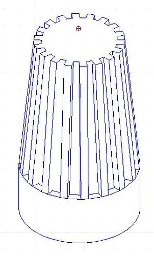

Is there a good tutorial on using the two cylindrical projection tools ? I’m trying to do something similar to this but can’t figure out how to use the projection tool properly.

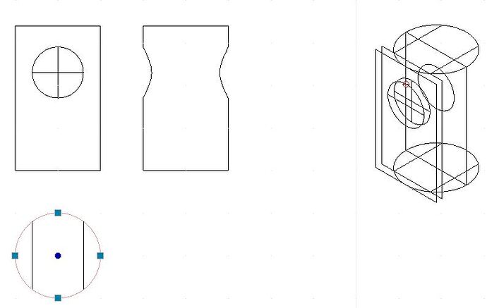

I can use the isometric projection tool to do the basic projection but I can’t figure out how to draw the line where the two cylinders intersect (i.e. the hole). It’s not an ellipse but a spline of some kind…like a Pringle potato chip lol.
I have my three orthogonal views done and was able to do a basic isometric view but i did not use the cylinder tool

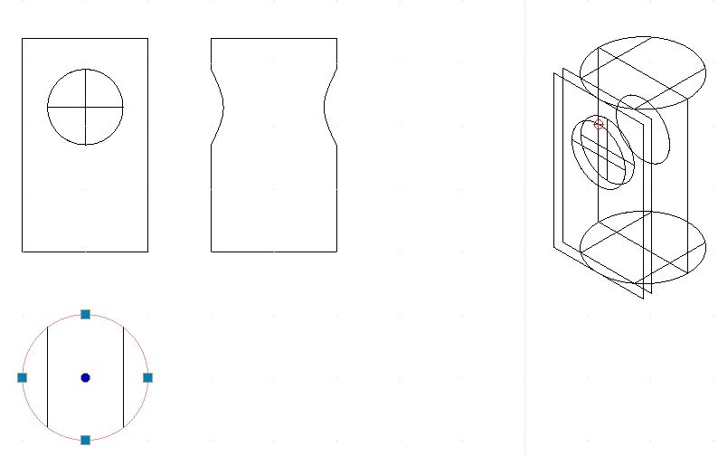

So I did it the way i learned back in high school almost 35 years ago! I think it looks the way it’s supposed to but I assume there is an easier way to do it with the built-in tools?

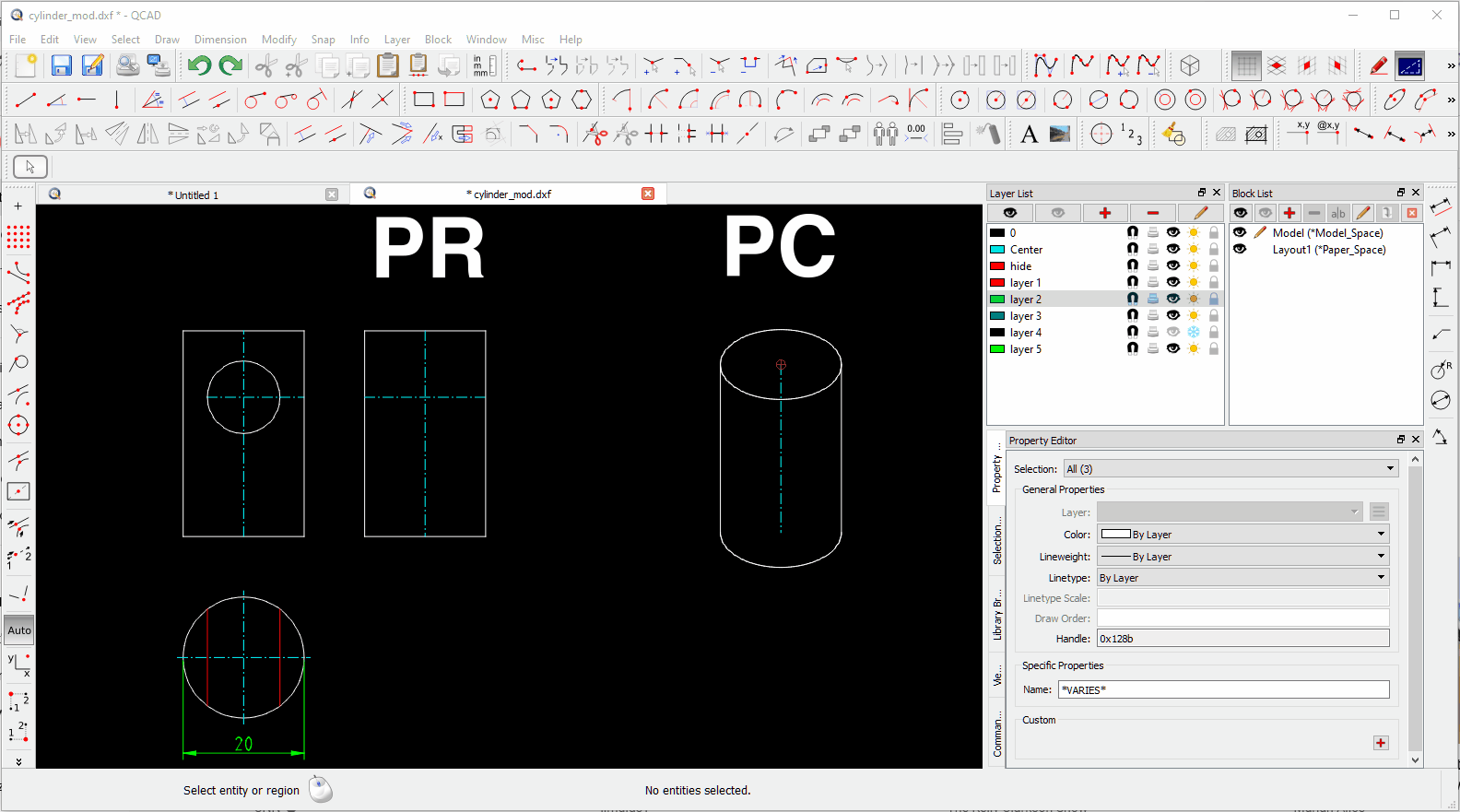

Please post the dxf where you are working on and I’ll check tonight how I can help you, ok? The dxf has to show what you try to accomplish … :open_mouth:

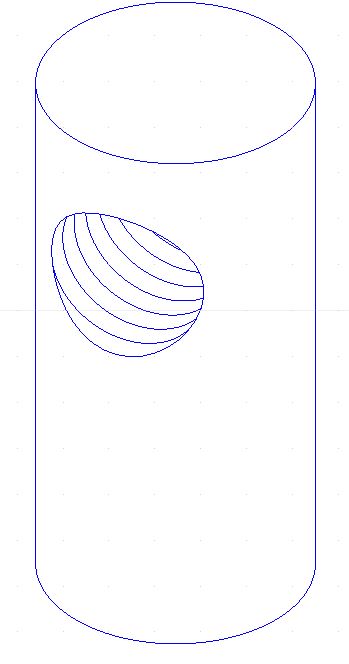

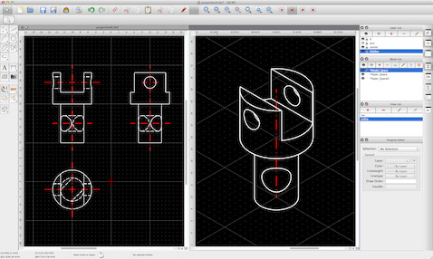

Here you go. I did the isometric view the old fashioned way by manually segmenting the cylinders and drawing the intersecting lines between the two. It was somewhat tedious to do so if there’s an easier way to do it with the tools, that would be great.

Hope this is helpful to you:

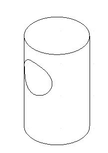

Outstanding. Real easy to use once you understand the tool. What took me about an hour to do manually was done in 2 minutes with the tool. I’m even happier that what I remember from high school gave the same results :open_mouth:
Thank you very much for the tutorial. Much appreciated.
And the ability to rotate the projection is even more useful. I rotated it by 20 degrees to make it look better.

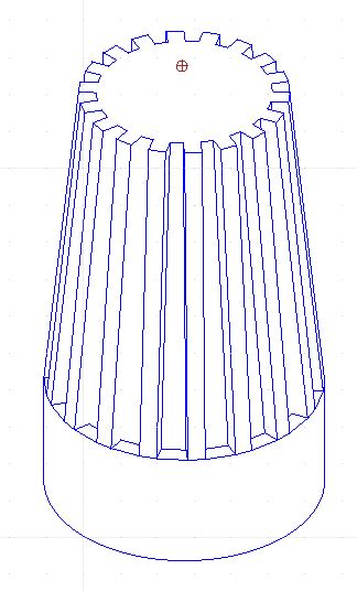

I added some “threads” inside the hole. I had to do the ellipse manually since I could not figure out how to “rotate” just a flat circle for the isometric projection
Looks good! :wink:
