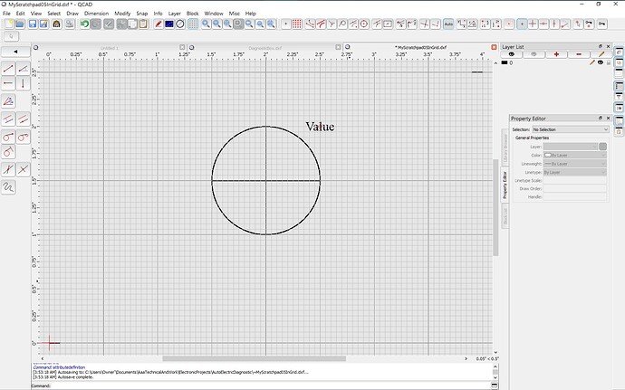

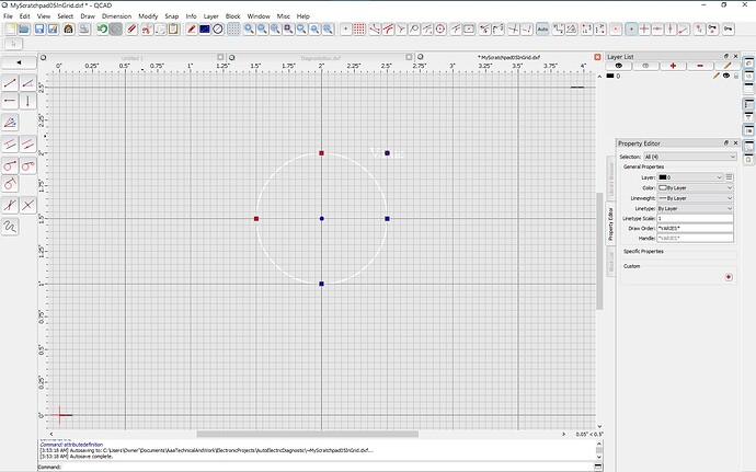

First I made absolutely sure there was only Layer 0 and no Blocks other than the mandatory two for every drawing. Everything was drawn on Layer 0. That includes the Block Attribute - I checked.
Then I saved it as a Library Part.

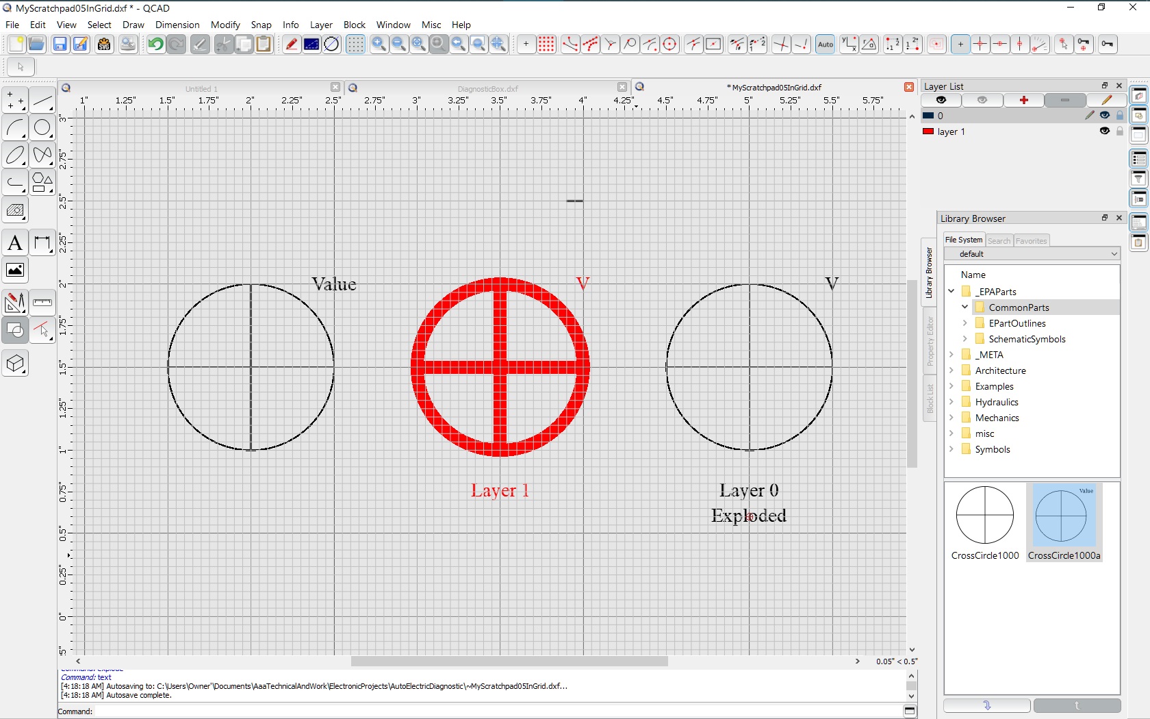

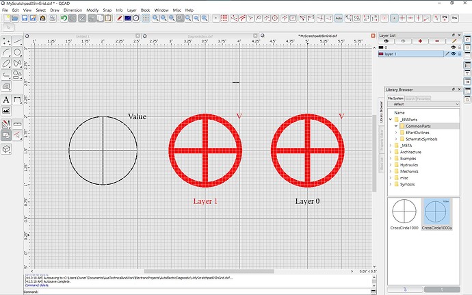

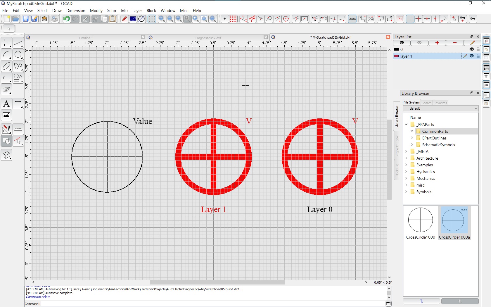

Next I created Layer 1 with red for it’s color and big, bold lines so it is easy to ID. And I inserted two instances of the Library Part ON LAYER 1. The two text labels were added to make it easy to see which layers were visible and invisible.

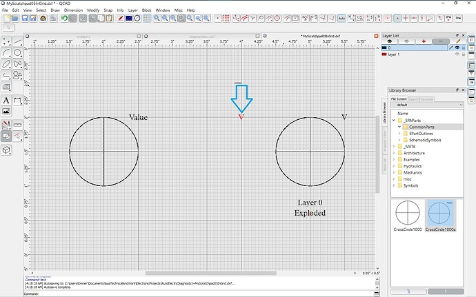

I exploded the instance on the right.

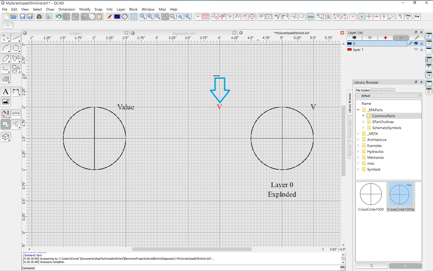

Now it gets interesting. With Layer 1 invisible, the remaining instance of the part disappears, EXCEPT FOR THE BLOCK ATTRIBUTE which remains visible and RED which is the color of Layer 1, not Layer 0 which is black.

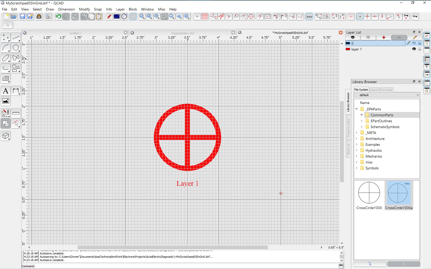

And with Layer 0 invisible, only the part on Layer 1 shows, not IT’S Block Attribute.
If I select the remaining instance of the part, the Property Editor says it is on Layer 1. But if I select only it’s Block Attribute, it says that is on Layer 0. Yet it is getting it’s color from Layer 1.
All components of the exploded part are on Layer 0.
The Block Attribute remains visible because it is created on layer ‘0’ and not on Layer ‘1’
<< Block Attributes are created on the intended layer by their Attribute Definition in the Block definition >>
The Block Attribute inherent the Block Reference color attribute, being on Layer ‘1’ that is red even when this layer is hidden.
<< For some reason Block Attributes entities associated with a Block Reference inherent the Block Reference attributes like color >>
This implies that you have ‘best compatibly’ active for layer ‘0’ because the Block Reference is lives on layer ‘1’.
Then this seems true even when the Block Attribute is itself not an entity defined in the Block definition, it is created from.
This is not true for orphaned Attribute entities because that are entities on their own.
All on layer ‘0’ is hidden except the Block Reference on Layer ‘1’ because of the ‘best compatibly’ rule.
The associated Block Attribute is itself created on layer ‘0’ and thus not visible.
