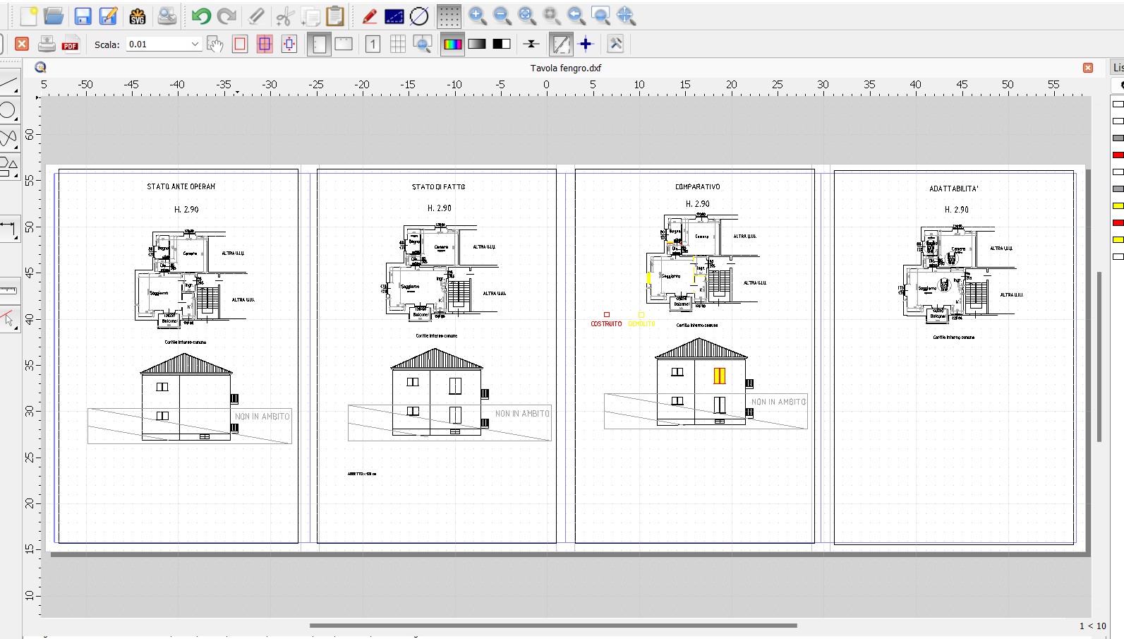

I am having isssue with QCAD stamp of more pages at the same time..
In particolar:

  2. is there a way to center the house plant and house prospects in each pages? Honestely I do not how to center everything. Should be an automatic features?
  3. if you look the write for instance “COMPARATIVO” STATO DI FATTO" and so on the top, how can I center in automatic way? so that will be perfect?
  4. where there is “non in ambito” in grey line, I would like to use a colored rectangle but if I do it I am not able to the the back lines on the back, I would like to use a transparent colour so that you can see the lines (like windows ) on the back

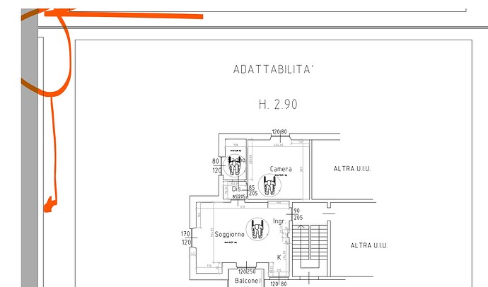

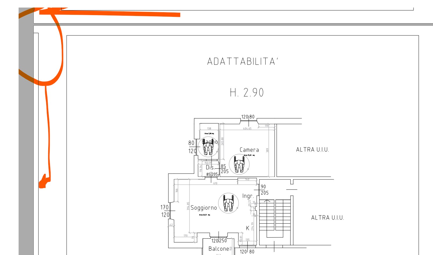

  1. I think that your multi-page printing is not configured correctly.
    If you use that then the the things in model space must be spaced so that they fit on the paper.
    You might want to explore the use of 4 layouts with viewports:
    QCAD - Tutorial: Working with Layout Blocks and Viewports
  2. For a single page it can be automatic.
  3. If the text is centered above the content it would be right.
  4. A solid hatch can have custom color and can be set semi-transparent.
    One can send the hatch to the back or the line art to the front … See drawing order, lower is more in the back.
For every single page - no.
For all pages together - yes.
Requirement in such a case would be that you match in modelspace the paper print dimensions. Looks to me that your frames in Modelspace doesn’t match those print measurements …
However - an easier approach would be to prepare a print in paperspace with Viewports.
Btw: The drawing isn’t a proper Orthographic Projection. The elevation view isn’t properly placed vertically to the top view. Not sure how important that is for you but I would fix that before it is printed - especially if someone else has to read it … :wink:

In the multi page printing preview the center looks aligned:
But left and right do not align perfectly:
You can fix this by rearranging the sections horizontally in model space.
As said, the inter spacing in Model Space has to match with the paper size.
This can not be automated as multi page printing serves other usages too.
Or you could use the viewport route.
See ‘Auto Center’ option on the Option Toolbar of the Print Preview.
If the text is centered above the content and the content is centered on a page then the text will also be centered … Right?

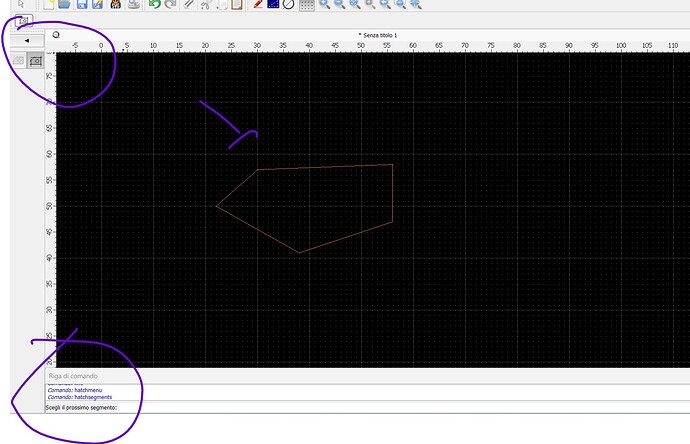

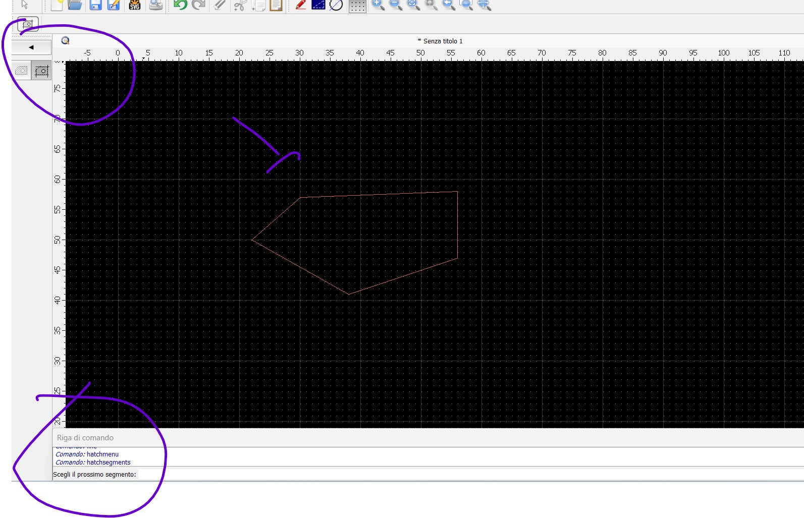

I don’t think that anything is/was pre-selected … The HA method is grayed out.
HS is active and requires you to indicate the boundary segments one by one with a left mouse click.
Once all these are selected you need to confirm your selection with a right click.
See instructions beside the mouse icon in the middle of your Status Bar.
If this is not showing then see menu View .. Status Bar or type the shortcut key sequence GS.
Ensure that your selection is perfectly closed or QCAD will throw a warning with where a boundary is open.
