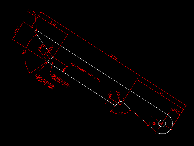

I was in need of a simple Table Saw Push Stick … maybe you too ![]()
Free to use for all QCad User!!!
Husky_Table Saw Push Stick.dxf (90.3 KB)
Have fun!!!

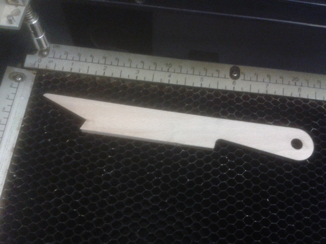

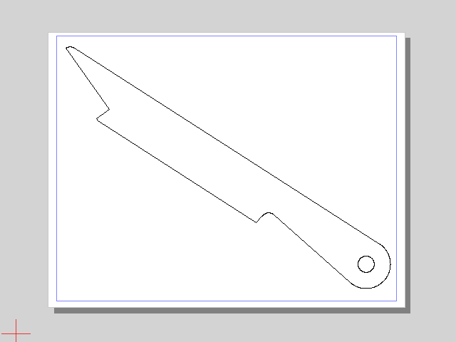

Thanks for this, I re-scaled your little push stick, changed everything to a continuous polyline and changed the line-weight to 0.00mm and cut out on the laser cutter.

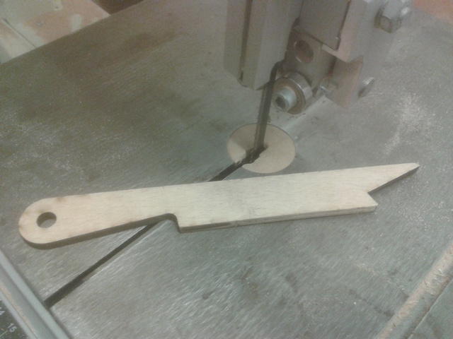

Now its perfect for using with the little bandsaw for small jobs, I`m sure it will be the first of many!
See below - photo`s of the ’ Husky’ push stick MK 1 ![]()
Nice!!! Thanks for the feedback! I like to see “Finger saver” around the world ![]()
