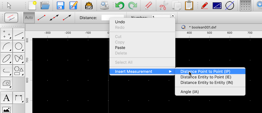

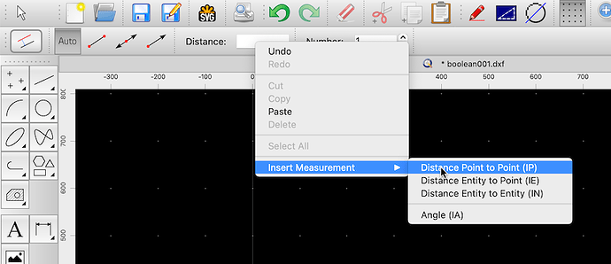

You can proceed as follows:
  • Start the tool that requires the distance
  • In the options toolbar right-click into the field where you want to use the measured value
  • Choose Insert Measurement and what you want to measure (e.g. Distance Point to Point)
  • Measure the distance as you usually would
  • QCAD enters a variable into the field (e.g. d1). This variable holds the measured value.
You can also enter multiple measured values and calculate the desired value with them, for example (d1+d2)/2, etc.
Here, we are using a measured distance for the distance of the parallel tool:
