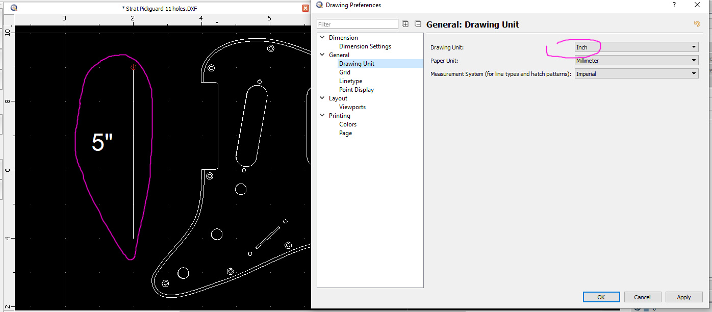

I try to print a file with a simple 2D design, with drawing-unit=Inch.
I added a line of 5" to check scale.
The line length on paper is good, but other things are too small.

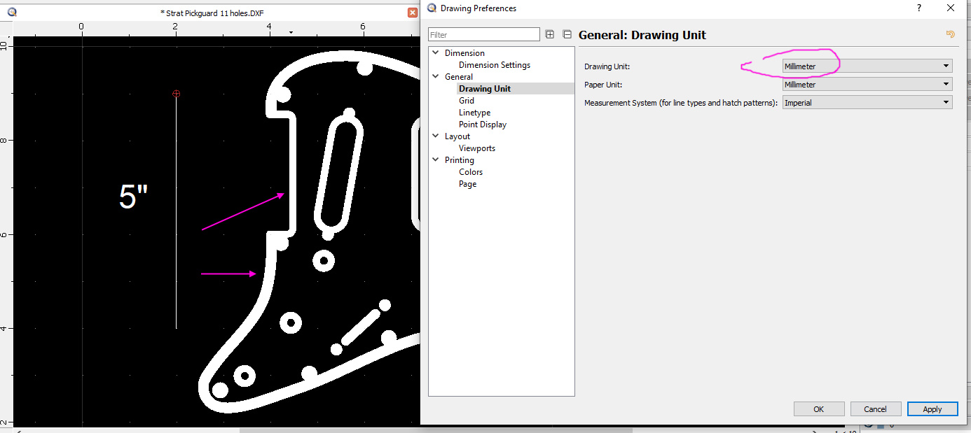

I searched in forum and people suggest to change the scale,
but when I change the scale, all lines become very thick.
I need to print this in accurate scale per millimeter.
See attached images,

so far I don’t quit understand what you trying to do. I’m sure that is just me … :wink:
Your drawing is in inch,
you will print it 1:1,
it has no dimensions what means if you print it 1:1 it doesn’t matter how you call the unit on paper. 5" is printed as 127 mm.
So, when the 5" test measurement is ok where is the problem within a 1:1 print?
If you change the unit within the Drawing Preferences you only change the name of the unit! A 5" line is then called a 5 mm line. More to that when I understood your task …
Changing Edit / Drawing Preferences (Crtl.+I) to mm only changes the actual unit of the drawing at hand.
Anything drew 2inch will now be considered as 2mm.
We don’t know at what state you added the 5 inch line.
The lines of the draft you point at in the second picture have a lineweight of 0.15mm.
They look thin on an inch grid from what they originated considered the piece is 7.6 units high.
And they will look 25.4 times fatter on a mm grid. :wink:
Took the test, viewed zoomed in inch one would say the lineweight is about 0.006 units in relation to the grid.
0.006 inch turns out to be a pritty good guess: its 0.1524mm. :stuck_out_tongue:

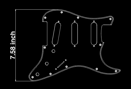

Thanks - I think I understand know the issue. I’m going to briefly explain it to you what is going on but first I need the “real world” measurement confirmation.
  1. Would you say this could be the real world measurement in inch? If not - what should be the dimension.
  2. What is the idea behind the unit change from inch to mm?
I should thank you ! (-:
    No, 7.58" is too small, it should be around 9".

Compared with the provided photo and the 9 inch guess the drawing is drawn to small!
I think more accurate would be 8.62" instead of 9". BTW - we can stick to inch!

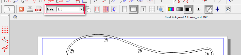

Regarding to this findings I scaled the drawing with the QCAD “Scale” tool. You can find the tool below Menu/Modify/Scale
Just select the whole drawing and launch the scale tool. I think the dialog is then self-explaining.

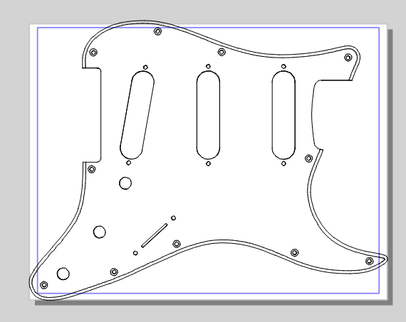

If we then launch the QCAD Preview for printing then we can see that this Workpiece doesn’t fits on an “ANSI A” page. So far I don’t know if that is a problem (maybe you are only looking for the drill pattern) or you’re going to print on a larger paper size.

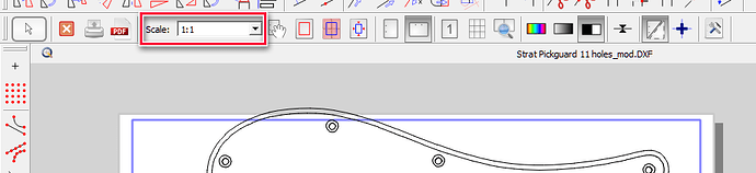

Howsoever - when you print the workpiece it has to be a 1:1 print scale.
Please check this modified dxf and tell me how it works for your project …
Strat Pickguard 11 holes_mod.DXF (162 KB)
