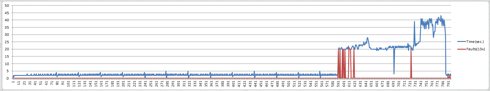

  • Speed:
    To start, the script needs on average 3sec for every move.
    After the first fault (592/797), that jumps to 20sec per move.
    At 742/797 that rises to 40sec per move.
    At 786/797 it drops back to 3sec per move.
    Even with 2 additional faults untill all were moved.

[SOLVED]
Moving all as one single operation, and without the failures, the runtime is about 1m 13s (or a 98,85% reduction :smiley: ).
  • less than a second for gathering information on 797 hatches and reporting 13 as invisible.
  • 20 milliseconds to create 13 sublayers. (also 13 and purely a coincidence)
  • 18 seconds to apply the operation and update the GUI.
  • 9 seconds to move 797 hatches and reporting each individual. (EAction.handleUser… to the command history is not so fast)
  • 45 seconds to apply the operation and update the GUI.
:confused: Applying the operations and updating the GUI needs 86% of the total run time.
And that is about the same as merely freezing or locking one layer.
