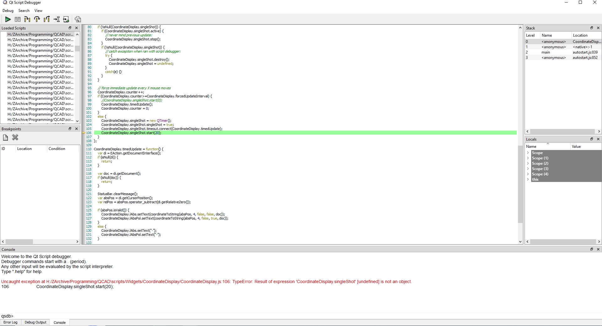

I generally run qcad with the debugger enabled (for debugging my own scripts) and I seem to randomly get an error popping up from CoordinateDisplay when using the program normally. It seems to happen when I’m just clicking on stuff and it doesn’t happen too often. I took a screenshot of the debugger window that popped up as a result (see attached image). Seems like a weird error. It is saying that CoordinateDisplay.singleShot is not an object (undefined) even though it apparently wasn’t undefined on the previous line? Any ideas?
Unfortunately, this is happens because events can occur in the wrong moment while debugging since the debugger forces event processing while running a script. For the same reason, the Qt script debugger can also cause random crashes and should only be enabled when really needed. Note that with Qt 6, the debugger has been removed completely.

i got sick of this one popping up randomly and ended up fixing it. You can fix it by editing the following file qcad/scripts/Widgets/CoordinateDisplay/CoordinateDisplay.js at f06aeaf19ebed0494aed72e8772441afbe97c85a · qcad/qcad · GitHub as follows:
The problem is that an undefined gets passed through the script sometimes and causes the debugger to pop up. Line 81 in CoordinateDisplay.js checks if CoordinateDisplay.singleShot is null. Add in another check to make sure CoordinateDisplay.singleShot is not undefined like so: && CoordinateDisplay.singleShot != undefined. You also need to change line 107 to an else if and add in the same two checks for null and undefined. It hasn’t popped up since making these edits.

Your own screen capture above displays the error at line 106 (That is from before Commit 5a73fc9 .. Oct 20, 2022)
Mentioned yourself, set to a QTimer on line 103 but failed 3 lines lower.
You can not catch this off by an extra test on ‘undefined’ in line 81 or 107 (current state).
Because it would fail somewhere between 107 and 111 (current state).
Events are simply not executed at due time or in the correct order in debugger mode.
Things may happen between evaluating and executing 2 lines of JS code.
