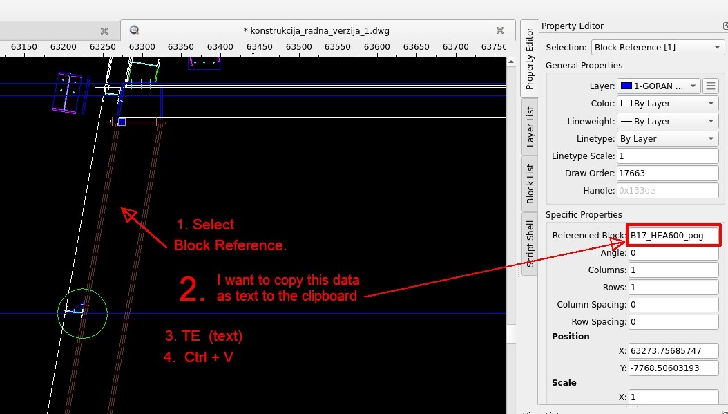

Hello QCAD users,
I need a script that will read the block name for the selected block and copy it to the clipboard (Referenced block name).
In the second step, this block name should be entered as simple text at the desired location in the drawing.
I have over 250 blocks whose names I need to write on the drawing.
Since I’m not a programmer, I tried to use artificial intelligence, but unfortunately, unsuccessfully :confused:
Anybody can help me with that?
Thanks in advance

I’ll try to describe what I want in the following image:
For me, success would be if I could select a block reference in the drawing and run a script with a shortcut that will copy the referenced block name. That would be more than 50% of the job. Now I wonder if that’s even possible?

With scripting almost anything is possible, your imagination and scripting skills are the limit.
Remark that most QCAD tools are scripts.
Not as you described in the 1-4 sequence, we are not going to copy the block name to the OS clipboard.
The QCAD clipboard is intended for copying geometry and the Specific Property is not yet a Text entity.
You can run a custom script with XC and indicating a script file from a file list.
With a shortcut’ … Then it must be conceived as an Addon tool … Remark that there are not many shortcut combinations left over.
Also, as Addon it has an action button … For example listed under Misc .. Block
Already happy that your QCAD GUI is in English.
For a single Block Reference that could be conceived as:
  • Select 1 Block Reference entity
  • Initiate custom Addon tool
  • Place text entity (With preview).
But that would still require 3x250 independent actions.

It is not about the third step, the first step is indicating a Block Reference entity.
Talking about ‘OP’, reread the post(s) and let us evaluate the original sequence:
  • Select a Block Reference entity
  • In the Properties Editor, navigate to Specific Properties .. Referenced Block
  • Select the entire contents of this text field
  • Right-click and choose Copy to the OS Clipboard
  • Launch the Text Tool (TE), adjust Font, Font Height, Simple Text and Alignments if necessary
  • Overwrite existing text with copied text (Ctrl+V)
A custom tool was requested for the above sequence. (See: 1_expl.jpg)
The text is then inserted in the drawing by the user.
  • Hit the OK button of the Text Editor dialog
  • With a preview indicate the insertion point for the Text entity.
  • Click left to confirm or right to cancel
