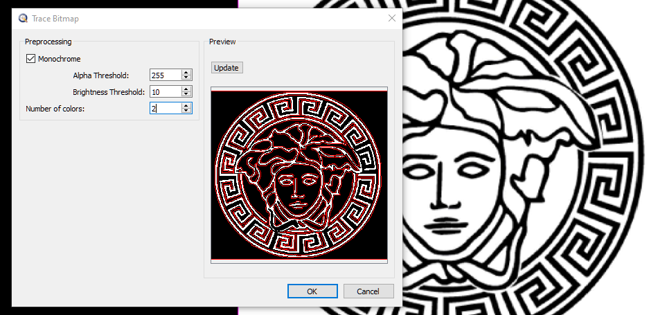

This is a well welcomed feature in Qcad but I seem to be having trouble with it.. :confused:
I’ve looked at the Help file but I need some guidance on the actual settings for tracing.
Below is an example from Inkscape v1.1 Appimage “I have used this for years” the Trace Bitmap settings are default values.. I tied default values in Qcad but could not achieve the desired result, I also tried setting to monochrome and played around with the thresholds but it shows a black screen and on an odd occasion locks up… :frowning:
Any help will be much appreciated and I’m very happy that this feature will now be a part of Qcad :slight_smile:

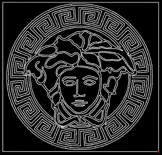

Please see below sample screenshots, image file used “Face.png” and dxf output from Inkscape…
PS FYI I had the same issue with previous Qcad Build 3.27.7
InkScapeTraceBitMap.dxf (514 KB)

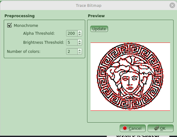

To get you started try this settings …

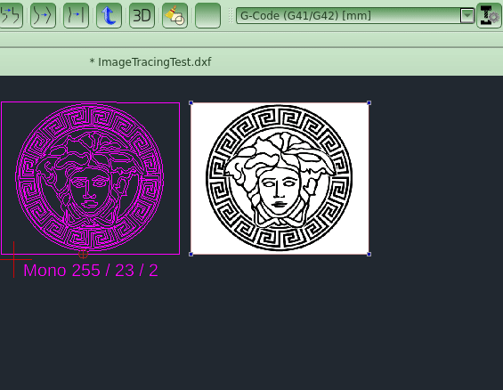

… what will produce something like this
I’m sure there is room for improvement but right now I don’t have the time to play with it … :blush:

Hi Husky
Okay I got this to work… but only after applying the default settings 1st
then changing them as per your suggestion..?

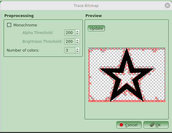

Hi Husky
It is a bit buggy though… for instance when monochrome is unticked alpha and brightness are not available :confused:
but when ticked they are ? should it not be the other way around?
Please see gif below..
BUG e_surprised

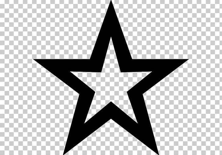

Sorry… :cry: I found more bugs… :frowning:
inconsistent results with same values entered
Here’s the file I tested with…
Essentially, ‘Monochrome’ means in shades of 1 color, In that case one has to define what shades to include/exclude.
I suspect that the number of colors doesn’t matter at that point.
In Peek 2022-10-07 15-38.gif, not monochrome and 2 colors it selects everything In white + black including gray or whole the bitmap.
Ticking ‘Monochrome’ here means that your bitmap RGB is turned into grayscale (8 BitsPerPixel) on the fly.
The weighted method would be Y = 0.299R + 0.587G + 0.114B e_geek
From the help file it is clear that the ‘Brightness Threshold’ then defines what shade of gray is considered background.
For RGBA there is the A-channel threshold (transparency).
But both ‘Thresholds’ then speak of all black, all white what in essence is black/white (1 BitsPerPixel).
Indeed, one would expect the same results from the same settings. :unamused:
Remark that you ask to reduce the color depth to 3 colors and there are indeed 3 spikes in the Histogram:
White, black and the gray from the checker board, all three with some nuances.
Jpeg files are not ideal sources because of the decompression artifacts, there are 220 unique colors in the star example.
What threshold is used for a certain color depth eludes me.

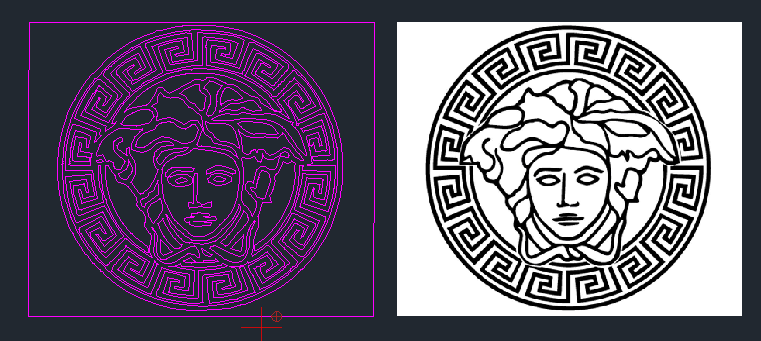

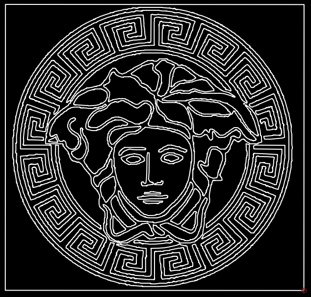

QCAD trace path is nothing similar or close to Inkscape Trace path.
The latter will export splines while QCAD sticks to polylines.
If we overlay the dxf over the Face.png (scaled 0.75), it is obvious that Inkscape draws an envelope around darker regions.
For this every pixel is locally weighted regarding their neighbors.
That picture has 397 unique colors.
Still, at some points Inkscape soften corners where we see/suspect hard corners.

Face.png is 446 x 380 px and star.jpeg is 728 x 508 px
