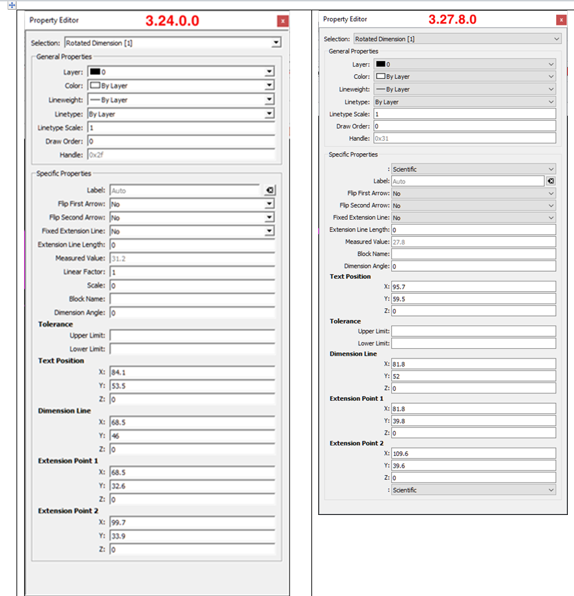

I’m using QCAD Community Edition 3.27.7 on Windows 11.
When I started my drawing, I was able to change the size scale factor of (existing) dimensions using “Edit/Drawing Preferences/Dimension/Dimension Settings/Size scale factor”. However, suddenly this feature stopped working and now I cannot switch the dimension scale factor any longer.
I used this feature to be able to adapt the scale factor of the dimensions when printing in different scales.
I.e. all my drawings are in “original” size but when it comes to printing, I print some parts in scale 1:2 (in which case I used to set the size scale factor of the dimensions to 2) and some parts in scale 1:10 (in which case I used to set the scale factor of the dimensions to 10). Using this procedure, the dimensions have the same size (font size, arrow size, gaps etc.) on both drawings.
I have attached the drawing, that shows the described issues.
Is this a bug in QCAD or am I using the feature the wrong way?

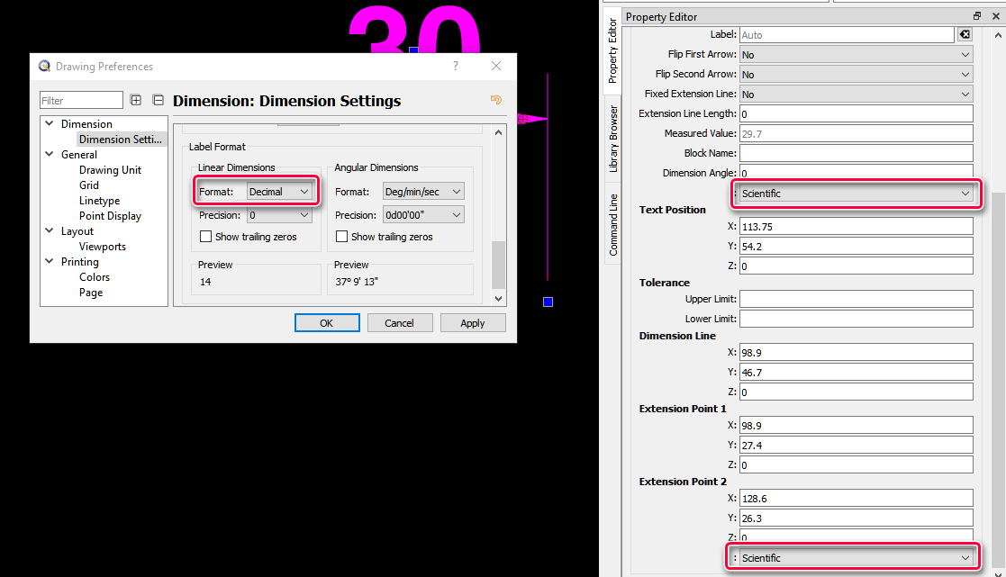

New drawing …
  1. Drawing Preferences / Dim Label Format = Decimal

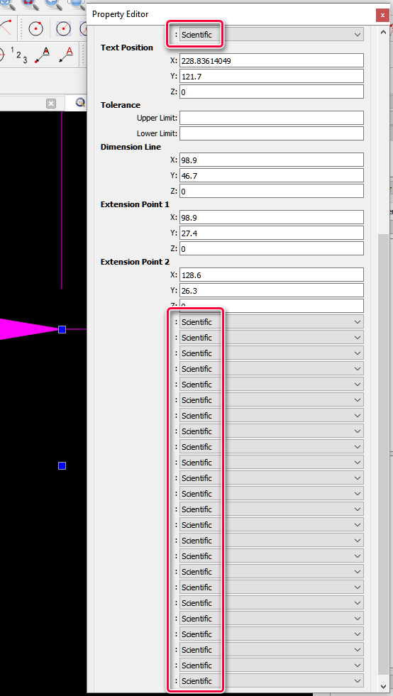

    creating a dim / selecting = Property Editor reads that it is a Scientific dim … two times.
2. Then changing the “Size scale factor” in Drawing Preferences / Dim from 1 to 10 or vice versa will flood the Property Editor with Dim Label fields …

There‘s another issue: In the previous version, when I selected a dimension, I had a “dimension scale factor” field in the property editor. With version 3.27.7 the “dimension scale factor” field in the PE has disappeared.

Correct - “Scale” is missing and two incomplete fields for “Linear Format” are now listed. The order makes no sense to me and it also doesn’t represent the correct settings below Drawing Preferences. Set is Decimal and the PE tells as it is Scientific. e_confused
This said - this is nothing which can be fixed with an adjusted program setting etc.. This goes to the core of the programing which is out of my hands. :blush:
