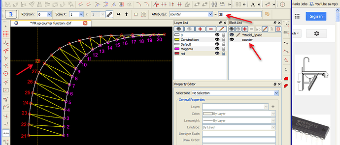

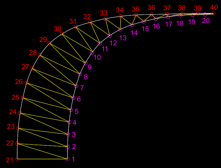

I find myself often in need to use consecutive numbers for any kind of labeling in my drawings. E.g. in drawings with flat pattern to keep track on the next step or for drawings with many detail views, scale views etc. etc. etc.

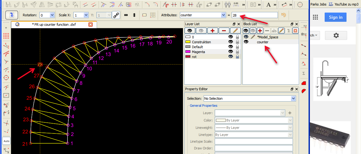

For this purpose I can use in QCAD the Text tool or the Block Attributes.
X-1Wtq0Mpbw
Both methods are working regarding this issue on the same way.

Step 1: Open the text tool - set the formation for the text - type “1” for the first Number - OK - click in the drawing to determine the position for this number “1”.
Step 2: For the next number (2) I can use the Option field to change the value - what means I have to place the mouse pointer in the value field (Step 3) - delete or overwrite the number with the keyboard keys to replace the “1” with a “2” (Step 3) - determine the position for this new number in the drawing (Step 4) and start over and over for the next 100 (?) numbers.
This over and over “manual number changing” is for me time consuming and distracting - I need to stay focused on my drawing and I think that should be much easier because … it’s a computer program.
Long story short: My feature request is pretty simple: I would like to have a sort of automatically “Up counting Number” tool as a new tool or maybe even better as an option for an existing tool (Text / Block Attributes).

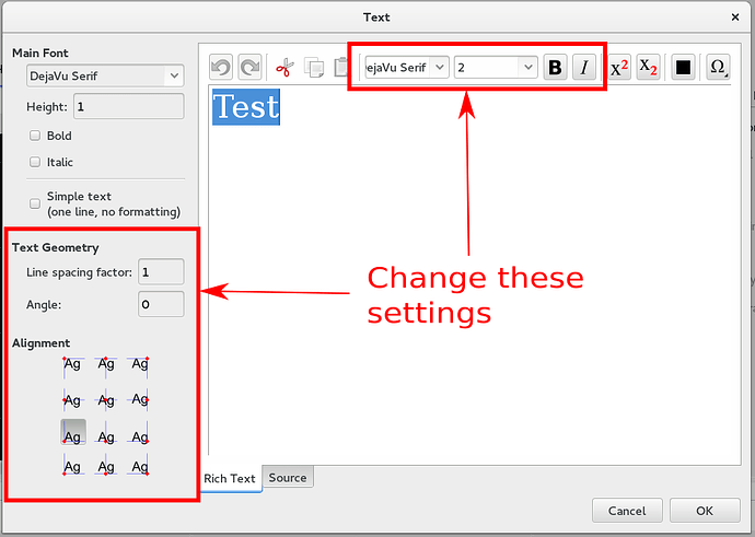

Now you may wish to change the font, angle and height of the text. To do this, use the ‘Text’ tool to set the options for the text.
As you can see from the picture you can change the Angle, Alignment, Font, Height, Bold and Italic options. (Changing the other options will have no effect). You can use the shortcut ‘TE’ to start the text tool while in the counter command. When you press the ‘OK’ button the settings are saved to the configuration file, which this tool then uses those settings. When the text tool prompts you for a position, press the right mouse button or press the ‘escape’ key on the keyboard, to exit the command. You will then be back in the counter tool.

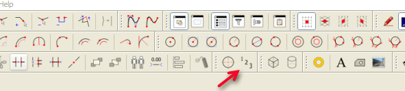

After playing with it I thought I’d rather have the icon in the modify tool bar as I keep it displayed all the time, so I tried to move the counter directory accordingly, but apparently the tool remains in the directory you suggested it should be in. Is that set in the script itself?
Thanks again for a useful addition.
Hi J-J,
whats about to display an extra Toolbar “Misc Draw” and put it next to your Modify Toolbar?

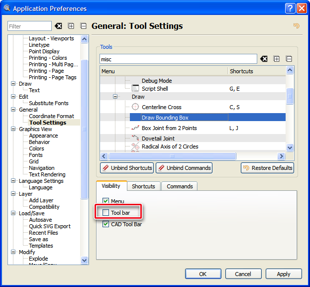

That’s what I did at first, but since I do not need the other tools that often, I thought it would be smarter just to have my “personalized” tool bar (I do that in Excel).
No big deal anyway, I have a large screen and I can afford a small extra bar!
I tried also the decimal incrementation, it is the start number that becomes polluted after 3 steps.
Nice work
Me too! I’ve just disabled all “unwanted” tools and have never to deal with them again on the screen - until I change my mind … :wink:

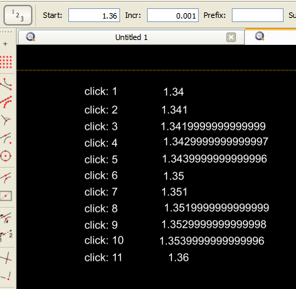

But I’m still facing problems with crazy numbers - maybe the tool should be limited to reasonable terms, I don’t know … :blush:
Start: 1.34 / Incr: 0.001

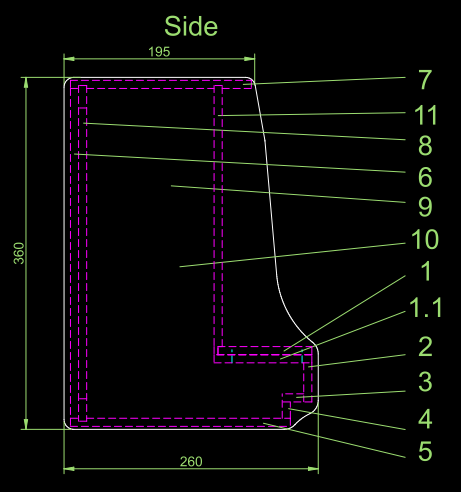

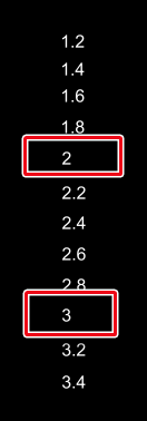

However - one more question: If I need to have a numerical series like this …
… do I have the power to tell the tool that I need to have the 2 and the 3 displayed with the zeros? Therefore 2.0 and 3.0 instead of 2 and 3. I played around with the Dimension Settings but without any luck …

I tried this on my computer, and it worked fine. On further investigation this appears to be a problem of precision. I set my precision from 4 to 2 decimal places, and I got the same crazy numbers as you. If you are using an increment of 0.001 you need to set the precision to at least 3 decimal places. So go to ‘Edit->Drawing Preferences → Dimension->Dimension Settings’ and set a suitable precision. I keep mine set to 4 decimal places for linear dimensions and 2 decimal places for angular dimensions. Give this a go and let me know if this fixes it.
This is a fairly simple tool, which could become more complex by adding lots of different options for all sorts of situations. So you could end up continually adding more and more options. I would suggest instead, that when the number is 2, set the suffix box to “.0”, and then clear it for the next number. I realise this could become tedious if you have a lot of numbers to enter, but for the moment it is the best I can suggest. Alternatively, you could set the prefix to “2.” and set start number to 0, with an increment of 2. When you reach 3, you would need to set the start number back to 0, and the prefix to “3.”.

I have made a very small change to this tool, so now if you switch on ‘Show trailing zeroes’ and set the precision to 1 you will see a zero at the end of a number:-
1.0, 1.2, 1.4 … 1.8, 2.0, 2.2 … 2.8, 3.0 …
For more decimal places set the precision to the number of decimal places required, and switch on ‘Show trailing zeroes’. So for your example 1.34 set the precision to 3:-
1.340, 1.341, 1.342 … 1.350, 1.351 … 1.360 …
Note: If you have existing dimensions in the drawing, they will change to reflect the current precision and ‘Show trailing zeroes’, so remember to change the precision and trailing zeroes back to their original values when you are finished.
