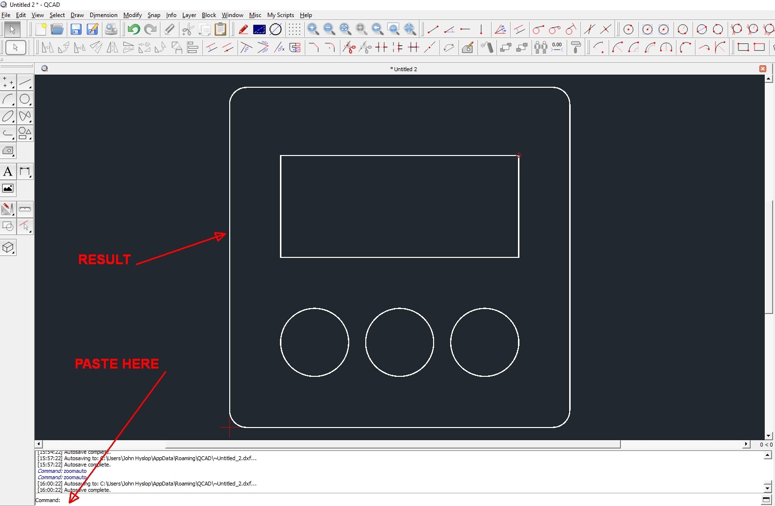

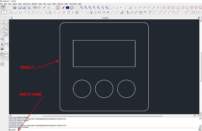

Is there any documentation on what can be pasted into the command line in Qcad? Everything below works except for the
CP command “Copy To Clipboard” if I type this manually it works
but it doesn’t from pasted text below… any Ideas? I’ve tried extra carriage returns… Also if I use MV " Move/Copy Command " is there a way to stop the dialog from poping up?
This works except the last part? Copy and paste below text into command line :wink:
QQ
LINE
5,0
95,0
QQ
LINE
100,5
100,95
QQ
LINE
95,100
5,100
QQ
LINE
0,95
0,5
QQ
AR
5,5
5
180
270
95,5
5
270
0
95,95
5
0
90
5,95
5
90
180
QQ
CIRCLE
25,25
10
CIRCLE
50,25
10
CIRCLE
75,25
10
QQ
RECTANGLE
15,50
85,80
QQ
ZA
QQ
SELECTALL
CP
Oops Forgot screenshot…

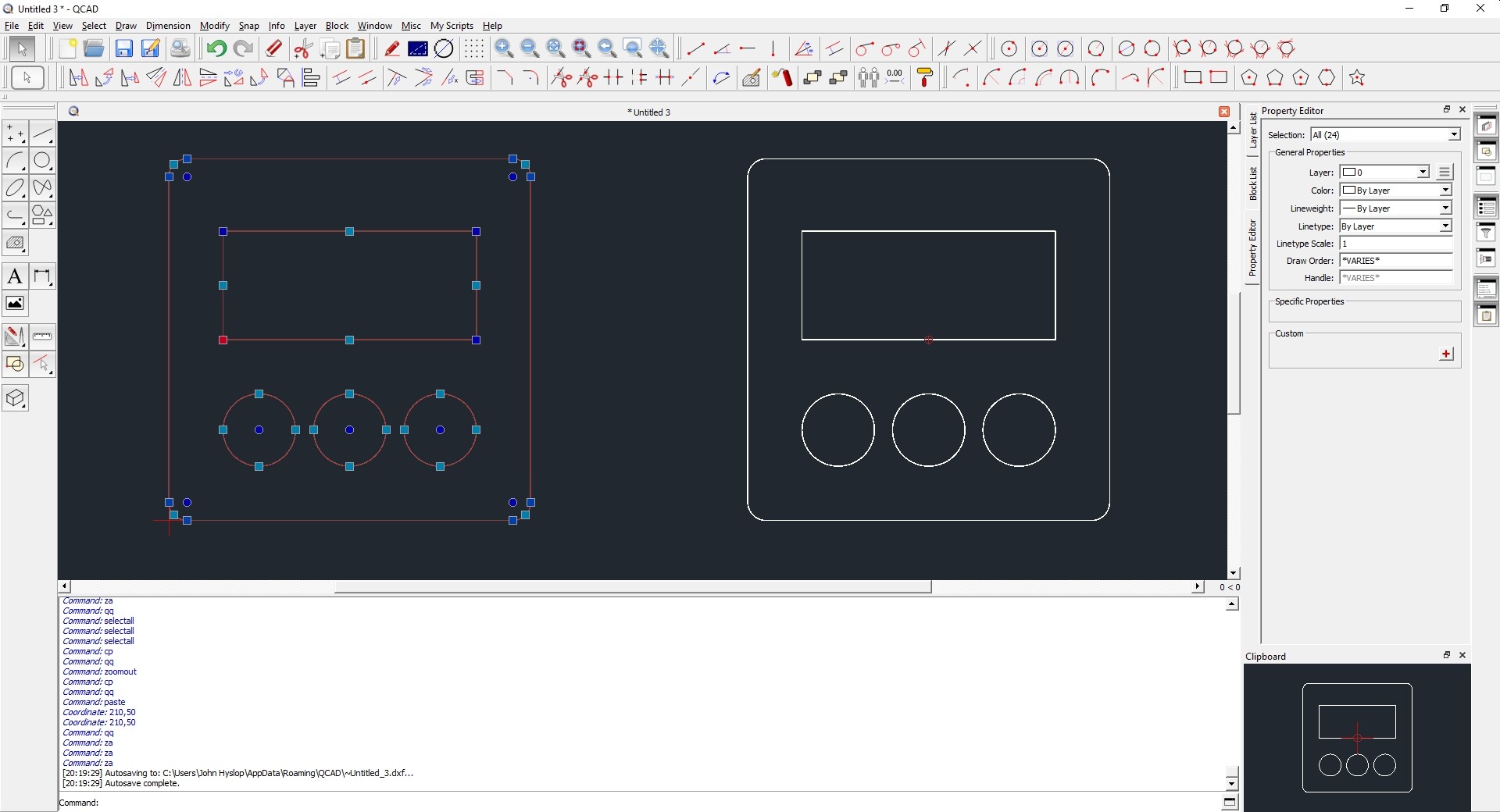

Now I’m having trouble getting it to work again? :blush:
You can clearly see in screenshot CP did work and paste.. I’m baffled.. :unamused:

Looking into this with a windows version of QCAD, I’ve discovered the problem is with ‘SELECTALL’ in file ‘Qcad Run Commands.txt’.
SELECTALL takes so long to complete that the copy command has been and gone before SELECTALL has finished. I don’t know of any way to pause or halt QCAD, so the solution is to delete everything after SELECTALL then add
QQ
ZA
to the end of the file to see the whole drawimg.
Then create a second file containing
QQ
CP
QQ
PS
210,50
QQ
ZA
I called this file ‘copy.txt’.
Copy everything in this file and paste it into the command line. Not very satisfactory, but at the moment it is all I can think of.
Manually selecting everything in the drawing seems almost instant on such a small drawing, but pasting is many times faster.
I tried adding multiple QQ’s to the file, multiple blank lines, and other commands to try and slow it down, but it didn’t work.
Perhaps you can think of a better solution.
