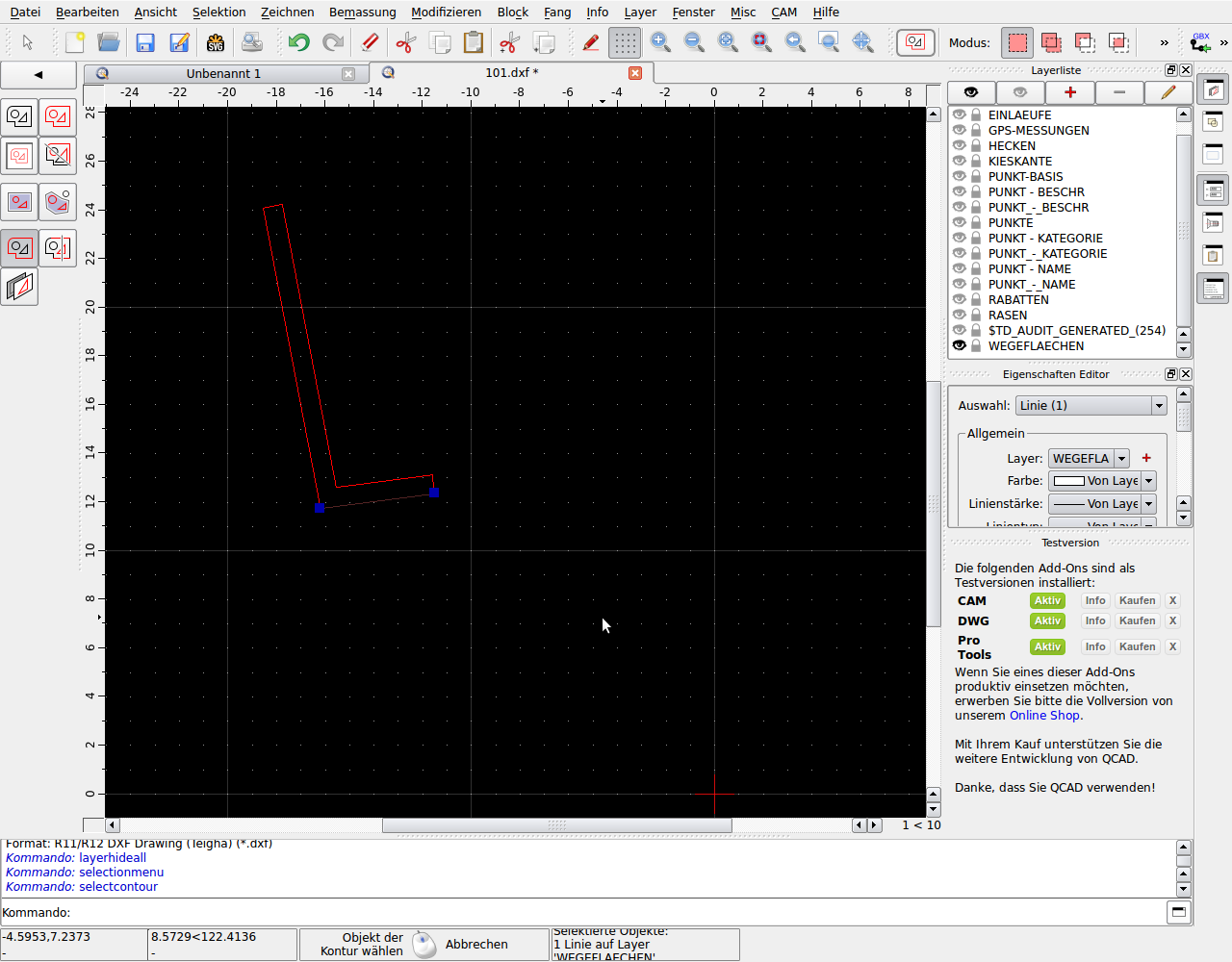

I found the command “select contour” wich does not seem to work for me. Even though two lines (on the same layer) share the same coordinates for one point only one line gets selected. I attached a file in my first post where I experience this problem. For example turn of all layer but the one called “WEGEFLAECHEN”. There is one closed contour that does not get selected. This does not work for any of my contours. Is there something wrong with me or my file!?

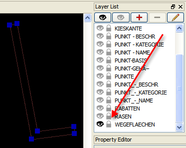

I have no problems to select the “WEGEFLAECHEN” contour! Maybe you have accidentally locked the Layer - please check the status of the Padlock symbol (black = locked / grey = unlocked).
I’ve noticed that the file you have attached contains Z coordinates (3D). While QCAD does import such files, there are several tools that might not work as expected since the coordinates are 3D, but the tools operate on the X/Y plane. This could be easily fixed by flattening the whole drawing, unless you do indeed need the Z coordinates.

No, it was not locked (see screenshot). One line gets selected, the rest not…

Yep - you are right! There are some issues with the contour selection.
Right now I’m only able to explain it with Andrew’s note:
