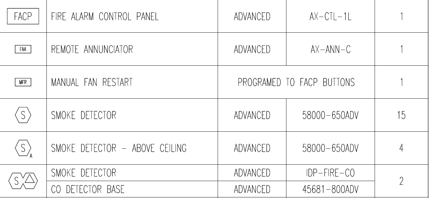

Is it possible to set up a counter to automatically add up the blocks so every time i add a smoke detector to my drawing it will add to the right column

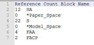

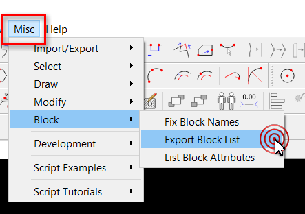

I can tell you that we don’t have something like that in the current QCAD Version but I can’t tell you what the developers have already in the pipe … :wink:
However - what I can tell you definitive is that the current QCAD Version has already a little simple script which will count blocks. :open_mouth:
Maybe that is something what you can use to doublecheck your chart …
Menu / Misk …
